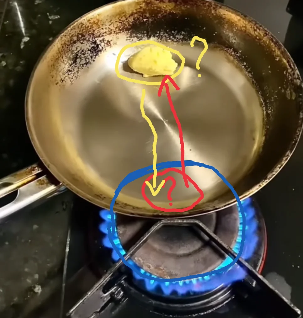

TL;DR
Colder mass has more density and sinks while hotter mass has less density therefore it raises, but where exactly do the convection cycle begins?
I’m having trouble understanding how exactly non-equilibrium heat-transfer initiates convection, whether or not phase change is involved.
Consider the following experiments.

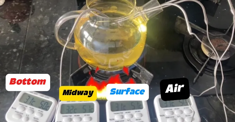

First: heating soy oil in a glass kettle on a regular gas stove; 4 probes — at the bottom, midway, near the surface inside the oil, and in the air above the oil (as in the image below); turn the fire on and follow the changes in temperature.
I was expecting that the bottom would lead — i.e., the temperature at the bottom, specially during active heating, would be hotter than the temperature at the surface.

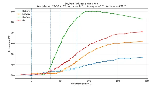

I plotted the dynamics on a chart:

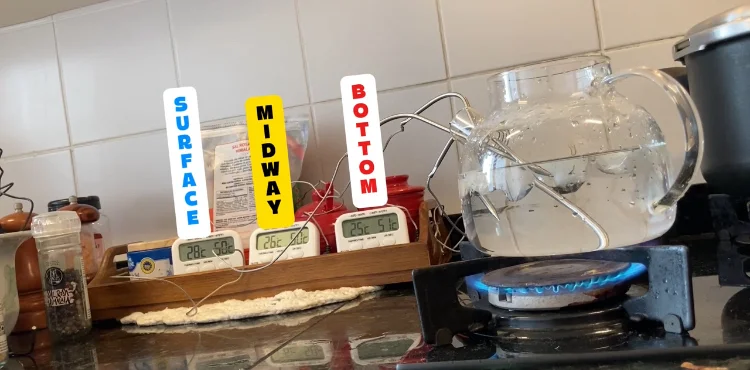

Second: same stove-kettle setup, 3 probes (bottom, midway, and surface, as in the image below), ice on the surface and fire on simultaneously; here again my naive expectative was that the button, directly receiving the heat from the fire would be hotter than the surface, especially while having ice still floating on the surface.

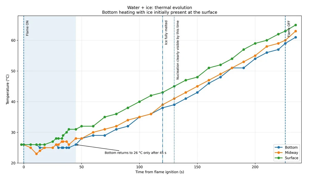

The data is on the chart below:
I have obviously repeated the experiments with different containers, different types of probes, etc., and the results were qualitatively similar.
Could someone explain how this dynamic happens?

I’ve been doing it and it is indeed good for seeing the motion, specially in oil, but my doubt is more about where the cycle begins, because, visually and from the data from the thermometers, it makes me wonder if it starts by colder mass sinking before hotter mass rises, but that doesn’t seem right, or does it?

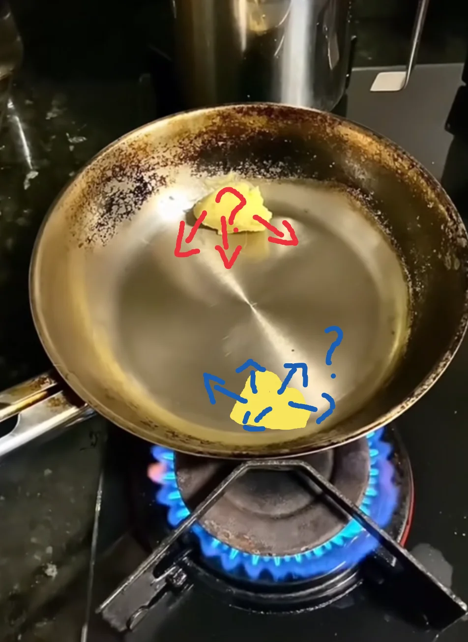

I understood that the convection cycle is at motion at the very moment the heat source is turned on, and that the motion upward and downward start also simultaneously, nevertheless, I still have a very basic doubt: is it the colder mass that displaces the hotter mass upwards or is it the hotter mass that displaces the colder mass downwards?
Both possibilities can result in a convection cycle, but their causality would be antagonistic.

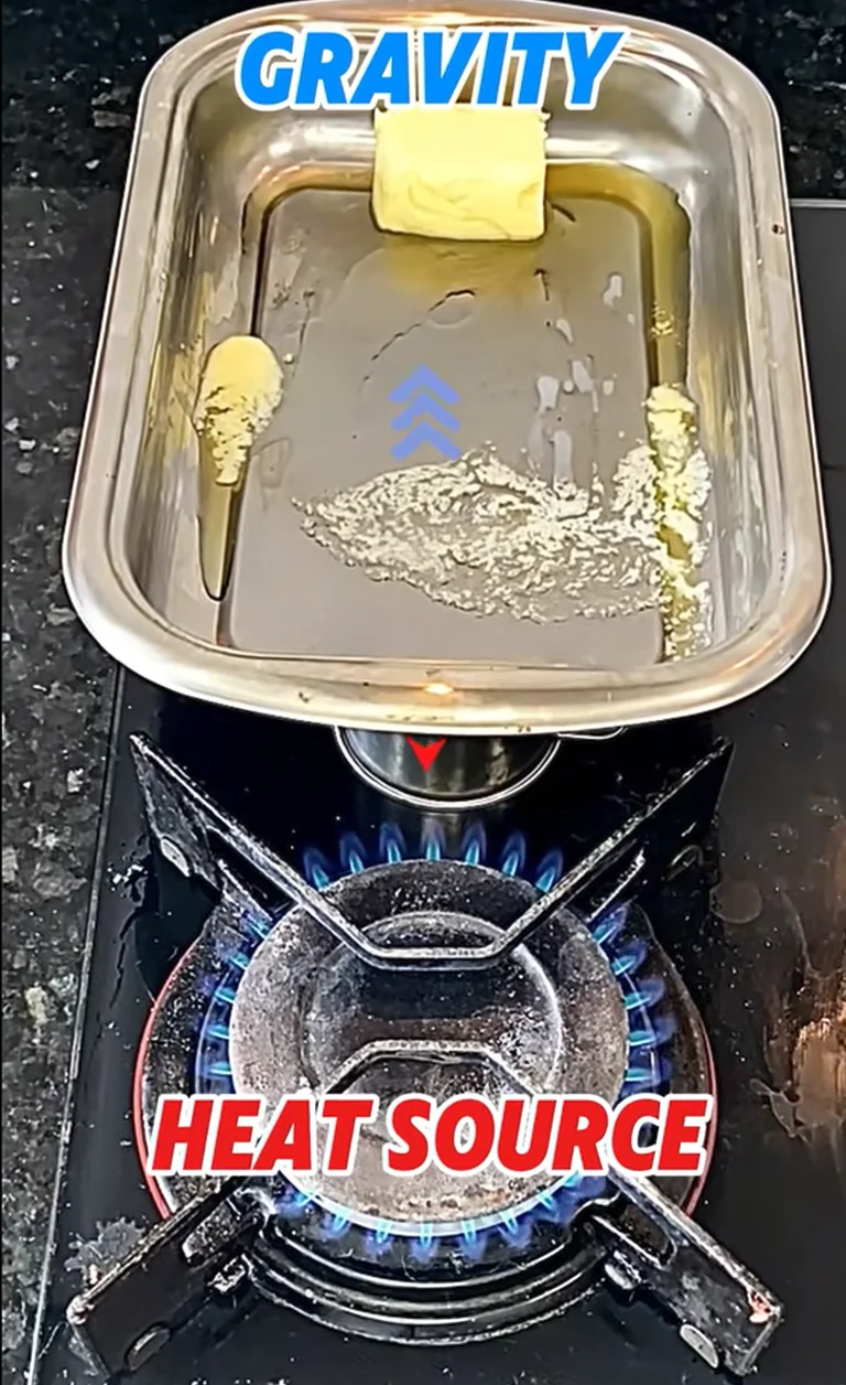

Without the energy transferred from the hot source into the cold liquid, there would not be the localized change of density; therefore, no convective movement withing the mass of liquid would be induced.
Note that the internal movement or mixing depends on the location of the heat source.
Relocating the heat source to the surface harmonizes the internal forces induced by thermal energy gain and gravity: the hotter and less dense superficial mass tends to "float" above the colder mass and to remain in its original location.

Ok, I understand that it may not be very simple to determine the outcome quantitatively from this setup, nevertheless, qualitatively, I would expect, in the case of the fire-water-ice experiment, for instance, that, while having ice on the surface and heat from beneath, that the temperature at the bottom would be hotter than the temperature at the surface.

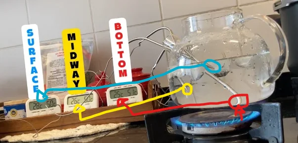

Whereas the bottom probe was placed directly where the flame touches the glass, the surface probe was at the center surrounded by ice.
At t=0s, all 3 probes read 26C, when simultaneously ice was put on the surface and the fire was ignited.
At t=45s, the bottom, after initially dropping 1C, returned to 26C, whereas the surface never dropped below the initial reading and had risen by 5C (i.e., reading 31C).
As the chart shows, despite the heat entering the system from beneath, and despite colder mass (i.e., the ice cubes) was floating on the surface, the temperature at the surface remained hotter than the bottom the whole time.

Using oil makes this discrepancy even greater as even the air above the oil is significantly warmer than the region where the heat enters to the oil — in that case, in 79s of flame, the bottom rose from 30C to 37C, whereas the surface rose to 84C (Δsb=+47C) and even the air above the oil rose to 51C.

The placing the ice makes the early evolution mechanical rather than thermal.

Actually, the oil shows exactly what I would have expected. Before convection sets in you briefly see the bottom layer being the hottest. Then convection sets in and draws the hot oil to the top.
This feature is barely at the limit of your experimental setup for oil. For the less viscous water and with the initial mechanical effects, it is not surprising that you miss it entirely there.

For the oil, yes. For the water I think that the viscosity is too low and the initial agitation is too great to see the same features with your setup.

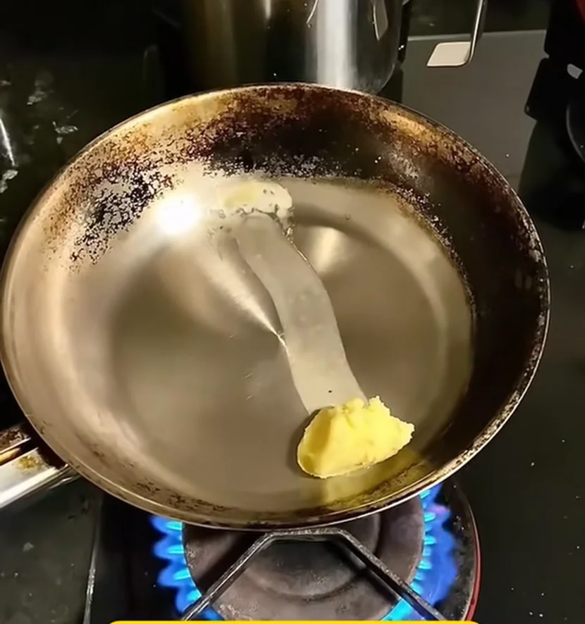

Ice is floating in hot water because it has no other option, it is the less dense actor in there.
Simultaneously, it is absorbing heat from (and therefore reducing the temperature of) the water and the air that is surrounding it.
The recoded temperatures could be different if the three probes were located exactly along a vertical line.
In the following video, the white color represents water at higher temperature than the one represented by yellow.
Note how the most superficial layer is cooled by the air, and how the water melting from the ice immediately sinks.
In this case, the mass of ice/water rate seems to be smaller than the one in your experiment, which greatly reduces the melting time.
I think @Lnewqban has it right; the water at the base gets replaced rapidly and mixed with adjacent cooler water whilst the warmer water that rises tends to accumulate at the top, especially if the heating is slow rather than fast enough to cause vigorous overturning and mixing through the whole container.

as far as I can tell that is what is happening. The bottom temperature is leading during the transient phase while a significant the thermal gradient is being established ( its penetrating depth is ## x \propto \sqrt{\alpha t } ## ). Initially ( 0s - 25 s ) Your blue line is climbing while your green line is flat. The mass of the water involved in the free convection is growing during this period ( from the bottom up as teh boundary layer grows) but in/around the 25 second mark the effects of free convection are beginning to register at the surface. They have been established throughout the entire mass of the fluid, and begin to dominate the thermal effects.
