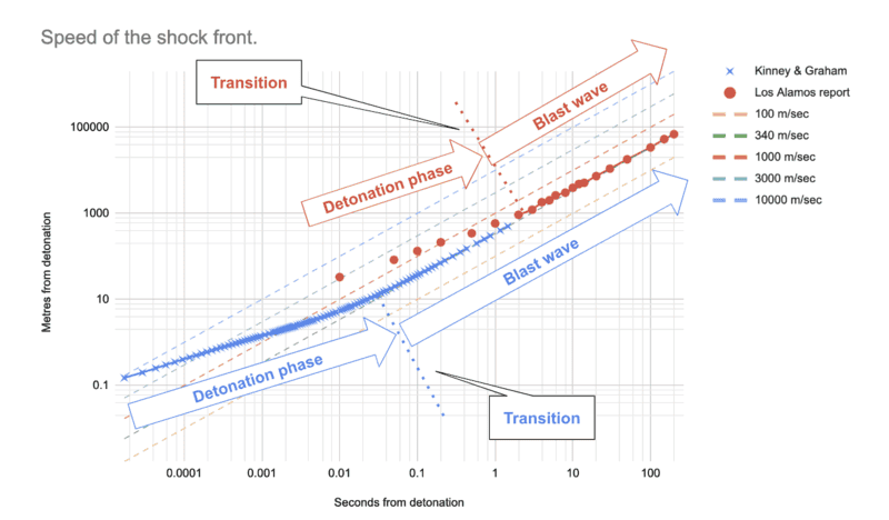

By consolidating shock propagation data from two distinct sources [1][2] into a single chart using a log scale for both axes, the contrasting speeds associated with two distinct phases of an explosion, which contribute to the formation of a shock front, become clearly evident.
Log-log chart of metres from detonation against seconds from detonation, comparing Kinney & Graham and Los Alamos report data with dashed lines for speeds from 100 to 10000 m/sec, labelled detonation phase, transition and blast wave.
The detonation phase involves the expansion of hot gaseous products at an initial hypersonic speed. This speed eventually decays to the speed of sound, marking the transition to the blast wave. The blast wave detaches upon the completion of the detonation phase and then propagates as a pressure wave at the speed of sound in the surrounding air, or Mach 1.0.
The timing and location of this transition depend on the type and size of the explosion, with the blast wave originating within milliseconds of the detonation of a chemical explosion up to a few seconds of a nuclear explosion. In all cases, the blast wave propagates at Mach 1.0.

What is your definition of "Mack 1.0" and "the speed of sound"?
During the detonation phase, the shock wave accelerates, then it begins to decelerate as it expands and moves away, with the fireball well behind it. Why do you include the decelerating supersonic shock wave, as part of the detonation wave, when it is usually treated as being outside the detonation, as an early part of the blast wave?

As you can see, after just 20 meters the blast wave has fallen from nearly 7,000 m/s to roughly the speed of sound at 340 m/s. Graph referenced from this article on Injury and death to armored passenger-vehicle occupants and ground personnel from explosive shock waves.
I have added the data from your Viano reference to the plot (in yellow) which shows a high correlation with the Kinney and Los Alamos data.
Log-log scatter plot titled Speed of the shock front, metres from detonation against seconds from detonation, with blue, red and yellow data series and dashed reference lines for 100, 340, 1000, 3000 and 10000 m/sec.

Could you please specify where and when the blast wave starts propagating from the detonation centre using the attached figure and data?
Log-log plot titled Speed of the shock front, metres from detonation against seconds from detonation, with three data series (Kinney & Graham, Los Alamos report, Viano) and dashed reference lines for 100 to 10000 m/sec.
You are plotting three sets of data there, each is a different magnitude, varying over a factor of maybe 1000. There is no one point on that plot, and because it is a Log-Log plot, the traces cannot be moved into alignment.

Here are my estimates of the (time, distance) coordinates of the shock fronts' transition to Mach 1.0.
Log-log plot titled Interpolated coordinates of shock speed transition to 340 m/s (Mach 1.0), metres from detonation against seconds from detonation, with three coloured curves for Kinney & Graham, Viano and Los Alamos and dashed lines of constant speed.

While the following table applies to both high explosives such as TNT, C4, and NH4, as well as nuclear explosions, the substantial variation in process intensity may make numerical comparisons somewhat obscure.
Properties​
Phase​
Phase​
"Hugoniot"​
"Friedlander"​
Propagation speedDecelerating from hypersonic to sonic.Steady, Mach 1.0
Conditions on blast side the shockHigh pressure, hot.Atmospheric pressure and temperature
Lifetime, secondsVery brief:<=10-2 for chemical, <=10 for nuclearLong: > 102
Propagation distance, metresVery short: <=102 chemical,
<=103 nuclear
Long: > 103
Survivable?NoYes
I suggest that the term 'detonation phase' be reserved for the brief, supersonic 'Hugoniot' phase, while 'blast wave' is more appropriately used for the extended sonic 'Friedlander phase' due to these distinctions.
