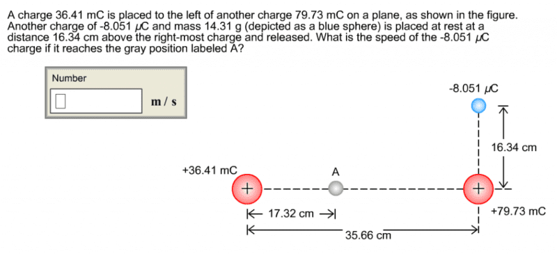

A charge 36.41 mC is placed to the left of another charge 79.73 mC on a plane, as shown in the figure. Another charge of -8.051 μC and mass 14.31 g (depicted as a blue sphere) is placed at rest at a distance 16.34 cm above the right-most charge and released. What is the speed of the -8.051 μC charge if it reaches the gray position labeled A?

This is a picture of the question. It's an online assignment.
http://i298.photobucket.com/albums/mm258/wolfboy2712/Capture-1_zps7d609984.png

Diagram of three charges on a horizontal line: +36.41 mC at left, gray point A in the middle 17.32 cm from it, and +79.73 mC at right, 35.66 cm from the left charge. A blue sphere of -8.051 μC sits 16.34 cm above the right charge, with dimensions labelled.

What is the potential energy of the "Blue" charge in its initial position?
What is the kinetic energy of the "Blue" charge in its initial position?
What is the potential energy of the "Blue" charge when it gets to point A ?
