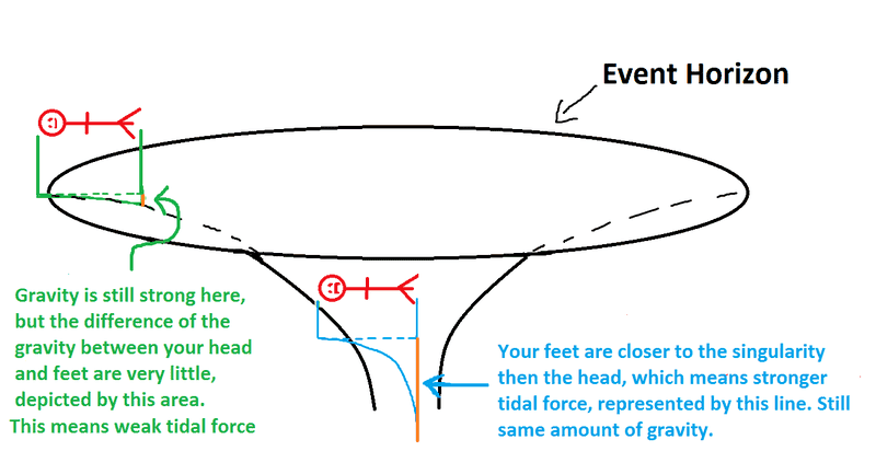

Maybe a picture will clear things up :)
Edit: Just to be clear, gravity does get stronger as you approach the center,
It's just the escape velocity at the event horizon IS the speed of light. So as you approach the singularity, the escape velocity just gets more and more then the speed of light.
Tidal force is what I'm depicting in the picture here, and is the reason why you don't notice much until you get close to the singularity.
Again, this depiction is only valid outside the horizon. At and inside the horizon, there is no way to draw a picture of "space", because that would require spacetime to be static, and spacetime is not static at or inside the horizon.

Again, this depiction is only valid outside the horizon. At and inside the horizon, there is no way to draw a picture of "space", because that would require spacetime to be static, and space time is not static at or inside the horizon.
I just don't see how this relates to anything? How else am i supposed to draw a black hole? It's inferred that space-time is collapsing infinitely at the singularity, I'm not going to bend my mind to try and depict something as abstract as that...especially in MS Paint :oldlaugh:

Look, my picture was only trying to visually explain what tidal force is. Everything else thereafter mentioned is nothing more then technicality based on my crude representation of the concept.
The OP said he's not a physicists, why bother dragging in a relativity diagrams which need a firm understanding in relativity to actually explain something like tidal force, when it can easily be expressed in a "euclidean" manner.
But hey i won't argue with you! I'm all for proper physics, i just want to make sure the OP understands what's going on in the thread he started :)
The OP's question was about how gravity works beyond the horizon. So showing him a diagram that doesn't apply beyond the horizon doesn't seem helpful.
Also, your diagram only illustrates tidal force in the radial direction. Tidal force also exists in the tangential direction.
it was hard enough drawing the stick figures :oldlaugh:
