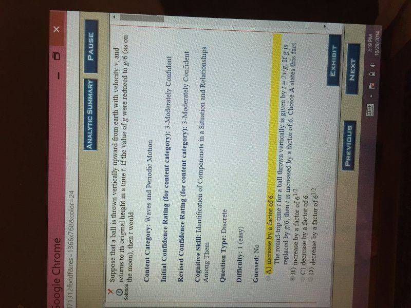

the AAMC used this formula to solve a problem that was asking what would happen to time if the gravity becomes g/6. the answer is that the time increases by a factor of 6.
v=v0 + at
I got the wrong answer by thinking that i can use the free fall equation x=1/2 gt2 Thanks in advance.

You need to post the entire original question.
Next time, please try to post the image the right way up.

I'm sorry about that, I kept trying to make it right side up but it wouldn't budge.
The one I need to determine is the time. The ones I know are acceleration (gravity) and velocity.

There is no such SUVAT equation. Do you mean s= v0 t + (1/2) at2 , or v=v0 + at?
Also, to what process are you applying this? E.g. the whole process from throwing the ball up to its landing again?
I'm sorry that was a typo. The equation was v=v0 + at
I was applying it to the whole process, from when the ball was thrown up to it landing

OK, so v0 is the velocity at which it was thrown up. What's the velocity just before it lands?
the velocity before it lands is v=√2gh

OK, you can do it that way if you can figure out h. Alternatively, what do you think the relationship is between the velocity it was thrown up with and the velocity it lands with?

OK, let's get back to where we were. What is the relationship between the initial and final velocities? They are not equal because they are not in the same direction, but it is a very simple relationship.
Are they inversely proportional to each other? Equal but opposite signs?

Do you understand what inversely proportional means? It would mean that one of them equals some constant divided by the other. There is no such process as division by a vector.
If you throw a ball up at 3m/s and catch it at the same height as it comes down, how fast do you think it will be traveling when you catch it?
It'll be traveling at 3 m/s when I catch it. I'm sorry I guess I meant they are proportional to each other but that would be wrong since they are equal with just opposite directions

Right, they are in opposite directions, so there is a minus sign that needs to fit in there somewhere.
So plug that into v_f = v_i + at noting that one of the velocities is a negative value (and taking appropriate care in whether the acceleration is up or down [positive or negative], with your chosen conventions).

Ok so if I let Vi be negative:
vf = -vi + at
If I move vi to the other side it becomes 2v
2v=at
2v/a=t
2v/g=t
is that correct?

That is one valid way to do it, yes. In that convention that you chose, down is positive. Since the ball initially thrown up, you tacked the negative sign on vi (and this assumes that vi itself is a positive number, equal to vf).
Edit: Or perhaps even better, you could have kept the equation in it's original form, vf = vi + at, and then made the substitution that vf = -vi. That way the formula remains the same, and it's only the values that change sign.
You also could have done it using the other convention where up is positive and down is negative. In that case a = -g, the initial velocity is positive and the final velocity is negative.
But if you didn't figure out before-hand that |vi| = |vf| then you could have derived the equation with y_f = y_i + vt + \frac{1}{2}at^2 knowing full well that y_i = y_f, using whichever convention that you chose (the convention of whether up or down is positive). So that's yet another way.
