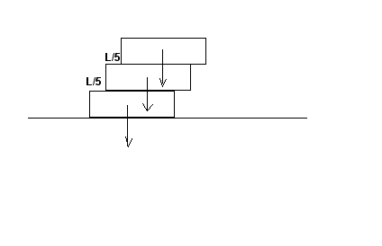

A homogenous brick with length L, is on a horizontal surface. On this brick are put one after another other bricks, which are the same with the first. Every brick is moved along L/5 units horizontally from the predecessor one. How many bricks can be put without disordering the equilibrium?
(L/2)/(L/5)=2.5
Since the bricks are homogeneous then the center of gravity is in the middle. So in the point L/2. So (L/2)/(L/5)=2.5, so there are 2 bricks.
(L/2)/(L/5)=2.5

I did it and I can't get to any conclusion. Look here http://imgur.com/sVHj4uB

Are you saying that your diagram does not convince you of the truth of Sammy's statement?
Taking it a step further, it's fairly obvious, if you continue the diagram, that you can do at least 4 bricks, but that may not be the end of it. I haven't worked it out in detail.

What I'm asking is whether or not your diagram convinces you that 3 works. Forget 4. Forget the final answer. DOES 3 WORK ?
Yes, I do. It has to do with the equation I said, right?

It would help a lot if you posted your diagram so we can see what if any mistakes you are making. For example it's tempting to think that it's only the centre of mass of the top brick that matters. That would be a mistake.

He posted a link to a diagram w/ 3 bricks, which is why I kept asking him if that diagram convinced him that 3 would work.

Hope this helps. It's now uploaded to PF.

Can you give me a hint? Cause I don't think the idea will come just like that
Here's a hint. Draw a dot at the center of mass of each brick and connect the dots. I say again, it's a matter of looking at the progression. Think about the dot-line for 2 bricks, 3 bricks, 4 bricks. Where is the total center of mass for each set (of 2, then 3, then 4)?

It forms a line that has an angle with the horizontal plane

This is the question you didn't address:
"Think about the dot-line for 2 bricks, 3 bricks, 4 bricks. Where is the total center of mass for each set (of 2, then 3, then 4)?. Where is the total center of mass for each set (of 2, then 3, then 4)?"​

I don't know
MaiteB said:
I don't know
Hint:
It's along that dot-line, somwwhere.
Try to figure out where that is.

In the middle of it?
