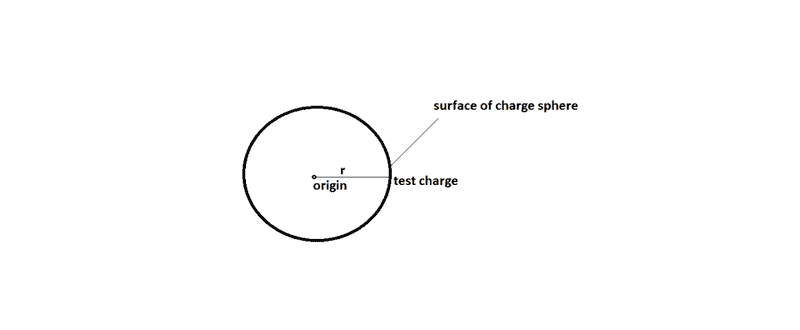

If charge -Q of mass m is kept on y-axis at large distance from the center,then it will execute oscillatory and periodic motion but if it is released very close to the origin then it will execute SHM .I want to know why?I mean how the distance from centre decides type of motion oscillatory or SHM?
What is at the origin to cause this? What, in your opinion distinguishes "oscillatory and periodic" motion from simple harmonic motion?
Edit: at a guess, we have a diffuse, spherically symmetric cloud with a uniform positive charge density centered on the origin. A charge far away sees an inverse square force law (-1/r^2) and a charge located within the cloud sees a force law that is directly proportional to distance (-r).

The Coulomb force.
According to the spherical shell theorem, the portion of the charge cloud farther from the origin than the -Q test charge cancels out to a net of zero. So only the portion of the cloud nearer the origin than the test charge matters. That portion of the cloud has volume proportional to r3 and inverse square attraction proportional to 1/r2. That means that the net attraction is proportional to r.

Uniform charge density. Sphere with volume that goes as r3. So total enclosed charge proportional to r3. Field equivalent to that charge at origin. Inverse square force law. So net field strength at radius r scales as r3/r2.

So you agree that if we have a uniform cloud of charge centered on the origin and a test charge at distance r from the origin that the total charge closer to the origin than the test charge is proportional to r3
Do you agree that if this cloud of charge is spherical then the portion which is farther than r from the origin produces no net electrical field on the test charge? The spherical shell theorem should tell you this.
Do you agree that the field from the portion of the could which is nearer than r from the origin produces an electrical field on the test charge identical to that which would be produced if its entire charge were concentrated at the origin? The spherical shell theorem should also tell you this.

gracy said:
Should I think of coordinate system.
No. The coordinate system is irrelevant.
We have a uniform cloud of charge.
Somewhere within this cloud of charge is a point we call the origin.
Somewhere else within this cloud of charge we have a test charge.
We measure the distance from the origin to the test charge.
We call this distance "r".
We draw an imaginary spherical shell that is centered on the origin and has radius r.
This spherical shell encloses a certain volume -- given by 4/3 pi r3
It encloses a certain amount of charge.
The amount of charge is proportional to the volume.
The volume is proportional to r3
Can you see that the amount of charge enclosed by this shell is proportional to r3
If you keep everything else constant and double r, by what factor will the amount of enclosed charge have increased?
8 times?
