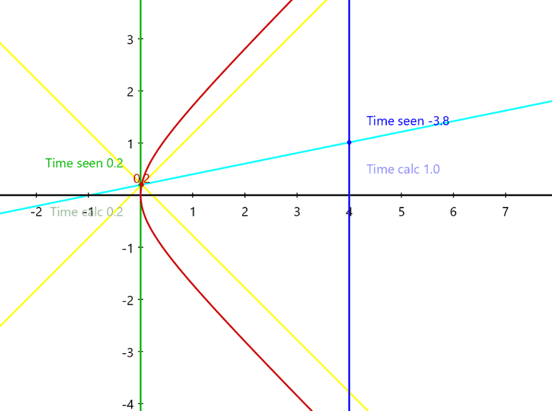

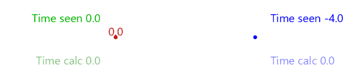

The discussion revolves around the interpretation of Minkowski spacetime diagrams and the perspective of an accelerating observer, specifically focusing on how such an observer perceives the positions and clock readings of other observers. Participants explore the implications of acceleration on observations, calculations, and the representation of these concepts through animations and diagrams.
  • One participant describes a Minkowski spacetime diagram generator and shares an animation depicting an accelerating observer, Alice, and her view of two other observers, Bob and Ted.
  • Another participant questions the accuracy of the animation, specifically regarding what Alice would actually see and how her observations relate to her acceleration.
  • Clarifications are made about the fainter dots in the animation, which represent calculated positions and clock times of Bob and Ted from Alice's perspective.
  • Concerns are raised about the validity of using a Minkowski diagram for an accelerating observer, as Alice is not in an inertial frame.
  • Participants discuss the implications of Alice's observations, including whether she would see Ted receding as she accelerates towards him.
  • There is a suggestion that Alice's ability to measure distances requires more than just visual observation, prompting a discussion about hypothetical measurement tools.
  • One participant expresses the need for clarity in the calculations being used to derive Alice's point of view, emphasizing the importance of accurate calculations in the context of the discussion.
Participants express differing views on the interpretation of Alice's observations and the calculations involved. There is no consensus on whether the animation accurately represents what Alice would see or how her perspective should be calculated, indicating ongoing disagreement and uncertainty.
Participants highlight the complexity of representing an accelerating observer's perspective in Minkowski diagrams, noting that Alice's instantaneous moving frame changes throughout the animation. There are unresolved questions about the calculations and assumptions made regarding Alice's observations and measurements.

Hmm...this is interesting. I don't know what you guys are talking about, but when Alice's clock reads 1 year, she has traveled 0.6 LY in 1.2 Y rest time and has a velocity of 0.8c.
I'm using the equations at https://math.ucr.edu/home/baez/physics/Relativity/SR/Rocket/rocket.html. He has a handy little table that says that at Alice's time 1 Y, the rest time is 1.9 Y, the rest distance traveled is only .56 LY and her velocity would be 0.77c, close enough because I'm rounding. This doesn't sound like a "a substantial fraction of the distance to Ted."
  • #35
PeterDonis said:
This one is easy: no.
Easy-peasy, but a one-word answer is not an explanation.
I'm willing to accept that my method of determining the distance Alice would calculate for Ted is wrong. I still believe she could calculate a distance (based on trig) and that this calculated value could be predicted knowing only the basics that I've described.
When Alice is at Bob's position, she sees what Bob sees and both should calculate the same distance based on the same trigonometry and come up with a distance of 4 LY. When Alice reaches Ted, she should easily calculate a distance of 0 LY. What is the proper method to determine the results of Alice's calculation at an arbitrary point in between?

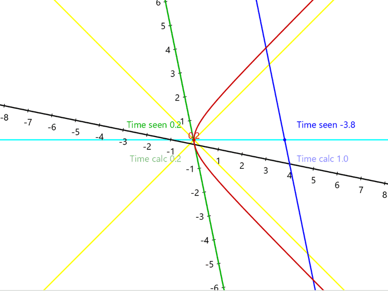

These values are correct in the original rest frame, the one diagrammed in your OP. But not in any other frame.
  • #37

  • #38

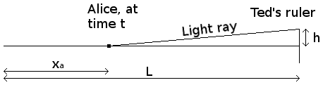

  • #52
Freixas said:
Or, even simpler, will Ted appear to shrink in the telescope?
Are you sure? I get an initial decrease in angle subtended by the ruler and then an increase. That does seem counter intuitive, so analysis is below in case you can see an error.
Working in Ted's frame, let Ted and the ruler lie at ##x=L## and extend from ##y=-h## to ##y=+h##. At time ##t## Alice lies at position ##x_a=\frac 1a\sqrt{1+a^2t^2}-\frac 1a## with velocity ##v=at/\gamma##, where the Lorentz gamma factor is ##\gamma=\sqrt{1+a^2t^2}##. Sketch:
A light ray arriving at Alice from the top of the ruler travels parallel to the three vector ##(x_a-L,-h,0)##. We can write a four momentum (up to a multiplicative constant we don't care about) for the light ray, then, as ##p=(\sqrt{(x_a-L)^2+h^2},x_a-L,-h,0)^T##which is manifestly null. Then we can transform that into Alice's instantaneous rest frame:$$p'=\left(
\begin{array}{cccc}
\gamma&-v\gamma&0&0\\
-v\gamma&\gamma&0&0\\
0&0&1&0\\
0&0&0&1\end{array}\right).p$$Finally, we can take the ratio of the ##y'## and ##x'## components of ##p'## to get the tangent of ##\theta'##, the half-angle subtended by the ruler for Alice expressed as a function of coordinate time in Ted's rest frame. That's rather messy:$$
\tan(\theta')=-{{ha}\over{{{\sqrt{a^2\,t^2+1}\,\left(-a\,L+\sqrt{a^2\,t^2+1}-1
\right)}}-at\,\sqrt{a^2\,L^2-\sqrt{a^2\,t^2+1}\,\left(2\,a\,L
+2\right)+2\,a\,L+a^2\,t^2+a^2\,h^2+2}}}$$
However, one thing is not messy. You can calculate the initial rate of change of the tangent of Alice's measured subtense, which is $$\left.\frac d{dt}\tan\left(\theta'(t)\right)\right|_{t=0}=-ha\frac{\sqrt{L^2+h^2}}{L^2}$$which is manifestly negative for any acceleration and size of object.
As always, I could have made a mistake, but I don't see where. A Maxima batch file to do all of this is spoilered below.

/* Vector from tip of ruler to Alice... */
dx:xalice-L;
dy:-h;
/* ...hence four-vector of incoming light from the ruler tip */
assume(a>0);
u:ratsimp([sqrt(dx^2+dy^2),dx,dy,0]);
/* Four vector expressed in Alice's instantaneous rest frame coordinates */
uprime:LT.u;
/* Derive the implied angle */
tanthetaprime:uprime[3][1]/uprime[2][1];
/* Calculate the derivative at t=0 */
substitute(0,t,diff(tanthetaprime,t));

  • #58
Thanks for all the assistance from everyone: @Ibix, @PeterDonis, @jartsa, and @PAllen.
Here is a corrected simulation. It is not as interesting. It represents Alice's viewpoint as she accelerates toward Ted. The faded positions are gone, the solid times still represent the Bob's and Ted's times seen by Alice, the faded colors represent Bob's and Ted's times as calculated by Alice.
With a few changes to the diagram, I can show a more typical view of the same data. Because of size constraints, I won't post an animation, but I will just capture the scene where Alice's tau = 0.2. The black axes are Bob's axes, green is Bob's worldline, blue is Ted's worldline, and red is Alice's worldline.
The cyan line is Alice's line of simultaneity. The yellow lines represent light and where they intersect Bob's and Ted's worldlines is where the light that Alice sees at tau 0.2 originates (and the source of the "Time seen" value).
Here it is from Bob's viewpoint:
And the same setup but from Alice's viewpoint:
Every intersection in one diagram has an equivalent match in the other. Although the animation might seem completely different from the two stills, it is about 98% the same thing.
Probably no one is curious, but I'll show the basics of the script used to create the diagram—the key elements, anyway.
There are three observers and they are defined this way:
let bob = [observer ]; let ted = [observer origin (4, 0)]; let alice = [observer acceleration 1];
Here's how the animation is set up:
let travelTau = dToTau(4, alice); animation reps: 1; let tau = 0 to travelTau step travelTau/500; let curAliceFrame = [frame observer alice at tau tau];
dToTau() is a function used to convert a distance traveled (4 LYs in this case) to a tau (local time) value for a given observer (Alice). This drives the simulation, which has 500 steps. I then grab Alice's instantaneous moving frame (IMF) at the point her local time equals the variable "tau", the one driving the animation.
let simulLine = [line axis x curAliceFrame offset tau]; let bobPos = intersect(simulLine, bob); let tedPos = intersect(simulLine, ted); let alicePos = intersect(simulLine, alice);
This line identifies the location of everyone along Alice's line of simultaneity. To get Bob's and Ted's clock readings as they arrive by light, I use
let light1 = [line angle 45 through alicePos]; let light2 = [line angle -45 through alicePos]; let bobLightLoc = intersect(light1, bob); let tedLightLoc = intersect(light2, ted);
Then I draw the positions as labeled events, where the label is the time seen. I add additional labels for the time calculated and I include an event dot for Alice:
event location: bobPos, text: "Time seen " + bobLightLoc.t, bobStyle; label location: bobPos, text: "Time calc " + bobPos.t, bobStyleFaded; event location: tedPos, text: "Time seen " + tedLightLoc.t, tedStyle; label location: tedPos, text: "Time calc " + tedPos.t, tedStyleFaded; event location: alicePos, text: tau, aliceStyle;
To show the animation so that it appears as a one-dimensional world (with the time dimension coming from
the actual time of the animation), I use this:
frame frame: [frame velocity curAliceFrame.v origin (0, tau) < curAliceFrame];
Basically, I modify Alice's IMF (only for drawing purposes) so that Alice stays in one spot. I'm also viewing everything from her point of view. The only things displayed are things occurring on her line of simultaneity.
