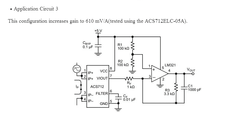

Some of the application circuits at your blog seem strange/wrong. Did you do the schematics or did you get them from somewhere. If the latter, where did you get them? Like this one for example looks wrong to me at first glance:

Tom.G said:
That happens to be Application 3 on pg. 12 of the Allegro datasheet.
Thanks Tom, that helps. I still don't understand why they would suggest using an inverting opamp to amplify a signal that runs between 0V and 5V...
I guess you could just invert the readings from your ADC, but why not just use a non-inverting opamp configuration?
