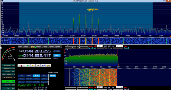

Just sharing, to explore EM theory you can build a highly directional 3 element yagi antenna and usecfree SDR software to analyse it. The only cost is a SDR receiver if you want quantitative data.If someone wants to edit me I will write a detailed method and parts list including a tone generator and RF transmitter diagram etc with about 10 parts, no soldering needs.
Super cool non trivial physics made easy.

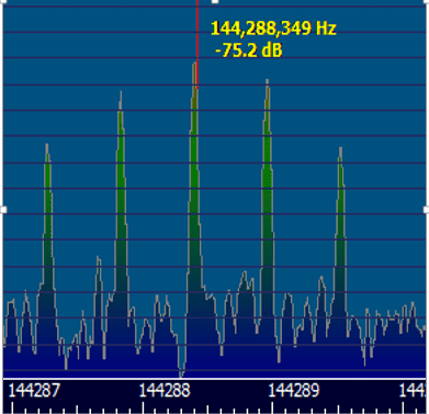

At 90 degrees he n was -120 at zero degrees gain was -70 at 180 degrees gain was -80... That is highly directional in my opinion.
The goal of the project is to optimise that and or add more elements.
Angles are rel to omnidirectional VHF transmitter at very low power.

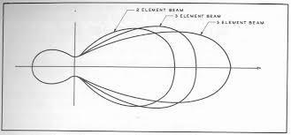

Directionality is not so much about comparing forward power to orthogonal power -- most Yagis will have good cancellation at 90 degrees. But as you add more elements, you get more directionality:

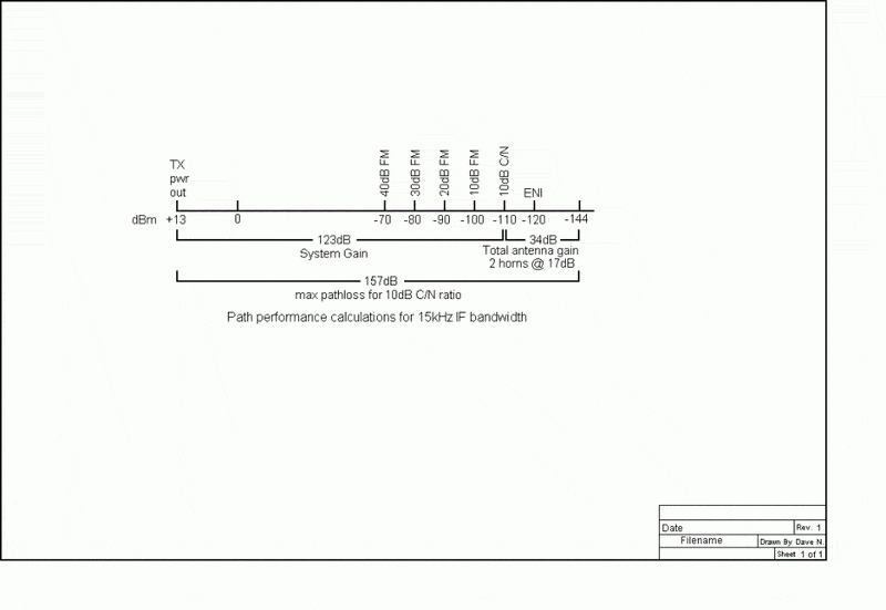

What the measurement tool reads is in reference to what is unclear.The -120 db is just the noise floor which changes every other day, -120db relative to what??
you missed the important reference -120dBm not -120dB
actually its quite easy to get a receiver sensitivity to -120dBm
have a look at this site ...
http://www.radio-electronics.com/info/rf-technology-design/rf-noise-sensitivity/noise-floor.php
and this one ...
http://cp.literature.agilent.com/litweb/pdf/5952-8255E.pdf
there are dozens of others
here's a diagram I drew up many yrs ago using various references, when I was deep into
microwave band communications
Dave

sample data, hope you can view it;
SDR interface;
noise
