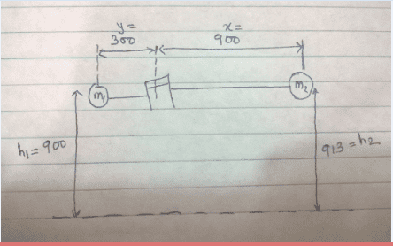

m2=3kg, m1=?
the diagram has been attached
I know that we find counterweights by equating equation mass x distance frm pivot but how do we find if it is at different height
Is it m1yh1=m2xh2
is counterweight at all dependent on height?[/B]

Does the full problem statement mention that the two beams to which the masses are attached are horizontal ?
If yes, then your attempt looks good.
Mass x g is force
force x distance from pivot is torque
No net torque means no angular acceleration => balance. g divides out.
Advice: draw the forces in the diagram.
That is basically m1y=m2x (in this case)
But what about the effects of h1 & h2 ?
The two beams are at different heights so will the approach change?

[edit] I am a bit too strict. Your "That is basically m1y=m2x (in this case)" is correct for equilibrium. It doesn't feature h1 or h2.

To be precise (and this seems to be the crucial point here), the distance in that formula is the distance from the pivot to the line of action of the force, not to the point of application of the force.

Sorry for the inconvenience.
m1 & m2 are in equilibrium , y= 300mm & x=900 mm and hence m1y=m2x.
So, if m1 & m2 are in equilibrium, will different heights have any effect? h1=900mm & h2=913mm.
h1 and h2 are not present in the expression, so they have no effect !
