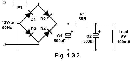

Hi,
I am a little lost here.
Circuit schematic labelled Fig. 1.3.3: 12V RMS 50Hz supply through fuse F1 into bridge rectifier D1 to D4, then C1 500µF, series R1 68R, C2 500µF across a Load of 9V 100mA.
What is the reactance of C2 at the ripple frequency? Can someone show me the steps to make this calculation?

1/(2*Pi*100Hz*C), but it's more complicated than that. What are you wanting to calculate? :smile:
Hi Berkeman,
A little background is in order. I am studying power supply basics and typical filter circuits used in those power supplies. There was a test at the end of the learning module and the above question was the only one I could not answer. The correct answer is 3.2 ohms according to the answer sheet.
Given only the information in the schematic one is supposed to be able to be able to compute the reactance of capacitor C2.
I think the writer of the module expected one to use .6 volts as the voltage drop across a diode as that was mentioned somewhere in the text.That would give a value of 1.2 volts.
That would give a voltage out of the bridge rectifier of 10.8 volts.
I don't know how to calculate the ripple frequency. My uneducated guess would be that the ripple would be about 10% of the rectifier output value of 10.8 volts.
So...the bottom line, given the above, by what process does one arrive at the 3.2 ohm answer?

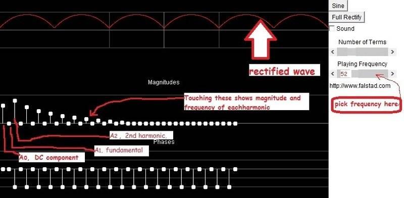

Here's a nifty simulated frequency analyzer that let's you select a frequency, full wave rectify it and look at the harmonics.
It's a great demonstration of Fourier Analysis:
http://www.falstad.com/fourier/e-fullrect.html
play with it a while
it doesn't have 50 hz but it has 52
Screenshot of a Fourier analysis tool showing a full-wave rectified sine wave on top and bar-style harmonic magnitude and phase spectra below, with red annotations for the DC component A0, fundamental A1 and second harmonic A2.
you'll notice right away that all the odd harmonics are zero, including the 1st(52hz) remember i said perfect rectification doubles the frequency..
Imperfect rectification would retain a small 1X line frequency component (and other odd harmonics).

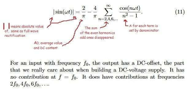

The math looks scary, this is for perfect rectification
Handwritten annotations on a printed equation: |sin(ωt)| = 2/π − (4/π) Σ cos(nωt)/(n²−1) for n = 2, 4, 6, ... (equation 11), with red arrows labelling the absolute value bars, the average value and DC content, and the even harmonics.
but all it's doing is making that sum of sinewaves
play around with that simulator
then with the FFT function in your fancy scope (FFT - Fast Fourier Transform)
when it begins to feel comfortable you have acquired a powerful tool for your "bag of tricks"
you should be able to see imperfect rectification using its FFT , odd harmonics will be nonzero

In the mean time I figured out the process to get to the test question answer.
Xc=1/(2piFC)
2xpi=6.28
6.28 X 100 = 628.30
628.30 X 500 = 314,159.26
1/314,159.26 = 3.18 ohms...rounded up = the 3.2 test question answer
So...here is the process and what is needed to answer the question without anything other than a pin and paper
1. Know the formula for Xc
2. Know what is meant by the words "ripple frequency" (Actually I knew the approximate frequency out of the rectifier was 100Hz, I just did not know that meant "ripple frequency")
3. Know the value of pi
4. Know that the frequency of 50Hz will be approximately doubled to 100Hz by a full wave bridge rectifier
5. Get the capacitance of C2 off the schematic
So...I was missing two things. One, I did not know the formula for Xc and two I did not understand the meaning of "ripple frequency" as it was being used in the test question.

Yes, I have looked at the ripple on the scope. I understand what it looks like. I did not and still do not know what the effect of C1 and R1 would have on the frequency at C2 if any. Is it still 100Hz? If the 9V 100mA load changed would that change the frequency at C2 also?
Cheers,
Billy
can't change the frequency, it's twice line just gets smaller amplitude as you add filter stages.
