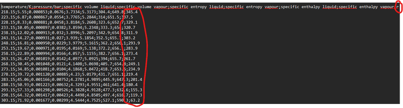

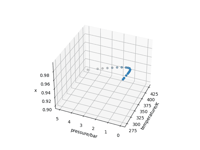

Leopold89 said:
Here I have the solution for water with an initial pressure of 5 bars and ##x_0=0.9##, where I used the steam table here. I have also adjusted the integration to your direction.
I am rather sure that this is wrong, because I need an initial mass and a fixed volume.
As I said in post #21, you don't need the mass and volume separately, only the mass divided by volume (the average density). You specified the initial state, so you know the initial mass fractions of liquid and vapor, the specific volumes of saturated liquid and gas, and thus the mass divided by tank volume. See Eqn. 3 of post #8.

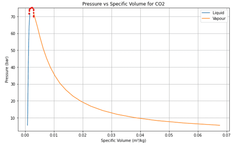

  • #32

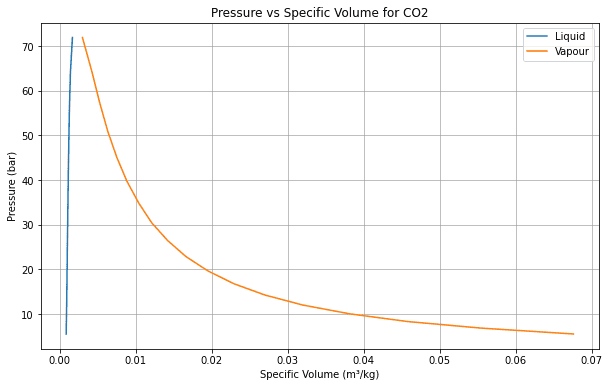

Here is the new curve for water. It looks plausible, since the more gas I release from the tank, the more vapour I expect.
  • #33
Now I am actually more confused. I thought the vapour-liquid temperature will get in balance with room temperature after some time, but now I see that my solution above may not even be defined for a measured pressure at room temperature. Does this mean I have to measure x at these ##p,T## and solve the same differential equation but in two dimensions with my expanded steam table?
Can you show me the thermal inertia of the tank, too, please?

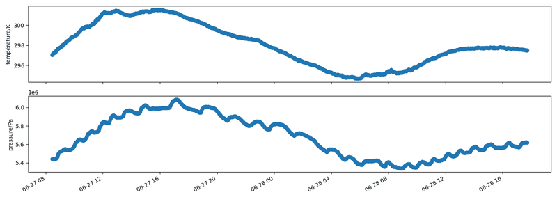

  • #37

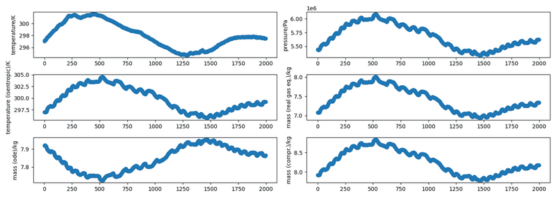

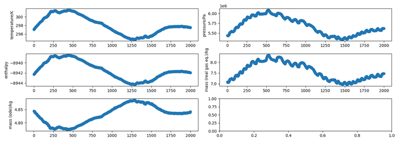

Somwhat yes. I have also included a plot of my data of one gas tank.
Edit: I think I understand now. The integrated curve is the same as the p-T-curve in the phase diagrams, so once I am above or below it, the model has to change between a pure liquid, a liquid-vapour mixture and a pure vapour/gas, right?
  • #38
Yes.

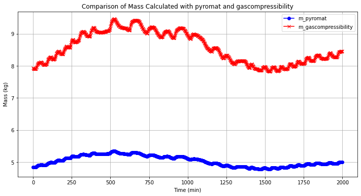

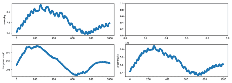

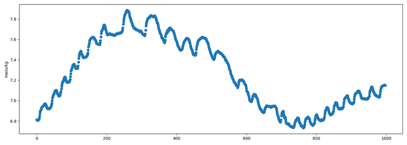

I am afraid I still don't understand. I attached here a mass plot of a tank with only vapour content. I used the ideal gas equation corrected for van der Waals forces, but not the thermal inertia. Now what we see is a contradiction with the experiment: You can only release gas, not introduce it other by replacing the whole tank, what did not happen during this measurement.
  • #40
The first law open system equation for introducing gas is different from the equation we used for removing gas. It should read $$dU=h_{out}dm$$ where ##h_{out}## is the enthalpy of the gas outside the valve.
  • #41

  • #43
The (room) temperature is the same as in post #3, so the temperature change is slower than the oscillation in the mass. The pressure data shows these weird peaks and only for this one gas (##\mathrm{CO}_2##), not the others, but I still get unplausible mass increases for the other gases, just not as dramatic as for ##\mathrm{CO}_2##. If the surrounding would give off heat, then I would have expected to see these peaks in other gas tanks as well, but I don't.
  • #44

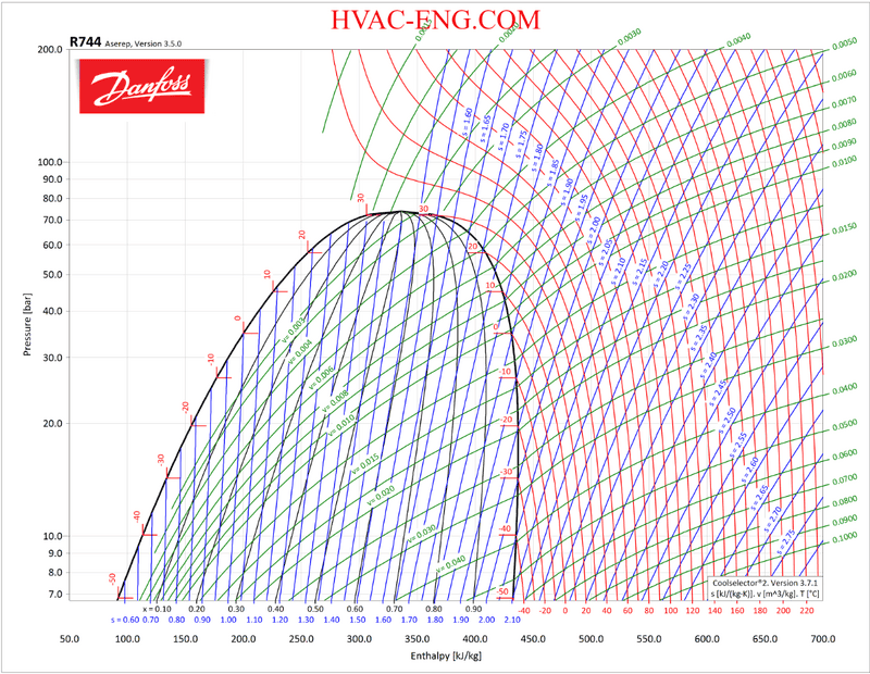

  • #45
Juanda said:
That system of differential equations should be solvable from the information I described. For greater clarity, here are the two equations together.
$$\frac{dm_{g}}{dt}+\frac{dm_{f}}{dt}=-\dot{m}_{out}$$
$$c_g T_g \frac{dm_{g}}{dt}+c_l T_l \frac{dm_{l}}{dt}=\dot{Q}-\dot{m}_{out}h_{out}$$

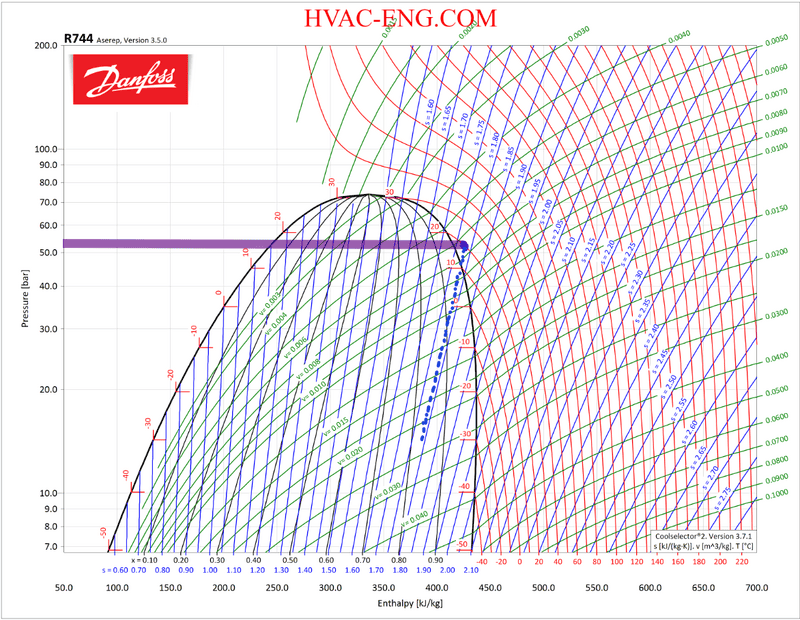

I'm now realizing that, as the discharge happens, the liquid will evaporate while temperature and pressure remain constant due to the phase change. Then, once it's all gas, its expansion will start cooling down the remaining gas.
Could that cooling condense it back?
Picture source: Thermodynamics_ An Engineering Approach by Yunus A. Çengel, Michael A. Boles and Mehmet Kanoglu from McGraw Hill (2023)
What I described in the previous post is using differential equations to model the straight segment. Once you're out of the bell (it's all gas), I thought it'd be fine to use the ideal gas law or something similar to find the remaining gas within the tank from the experimental data but I don't know if the path it follows is the red line bordering the bell or something else like the blue line. I don't think it'd be able to get inside the bell again due to its own cooling though.
Maybe it'd be interesting to model the behavior outside the bell with differential equations too to see how close to the experimental data you can get it instead of directly using the experimental data (PTV) to try to get the mass inside the tank by using ideal gas law.

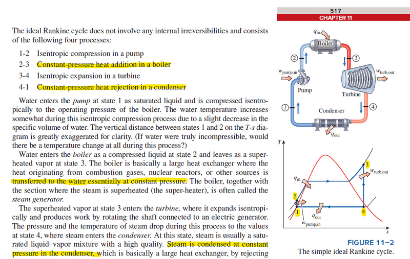

You have not specified whether the output flow from the tank is pure vapor or a combination of vapor and liquid (say at the mass fractions as in the tank). I assumed that the process is taking place slowly in a gravitational field, and that the output is saturated vapor only.
Juanda said:
Lastly, the energy in the control volume ##E_{CV}## will be only the internal energy of the gas and liquid because it's not flowing. It can be expressed as:
$$\frac{dE_{CV}}{dt}=\frac{dU_{g}}{dt}+\frac{dU_{l}}{dt}$$
Since it's a saturated mixture, it's going through a phase change. Therefore, its pressure and temperature should be constant.
This is only true if the system is forced to be at constant pressure. In a case like this, of constant total volume, both the temperature and the pressure are changing along the equilibrium saturation line and the proportions of vapor and liquid are changing.

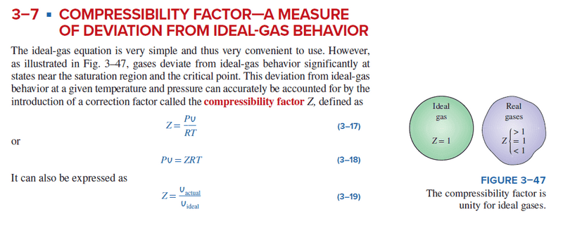

That's probably it. I'm a little rusty on this but, from what I remember, power cycles involving vapor always have that constant behavior inside the bell.
I checked THE book (Çengel) again and the constant pressure is mentioned. I assumed the constant pressure (and temperature) was a result of the phase change but the phase change is actually not even mentioned. So it is imposing a constant pressure inside the bell that is causing the constant temperature during that part of the process.
I don't know how to describe a phase change where the pressure is not held constant then. I feel I need more information.
No way. The temperature and mass fraction vapor are sufficient to fully establish conditions within the bell.
There is a big difference between constant pressure spatially and constant pressure temporally (i.e., during the process). In the Rankine cycle, the boiler is operated at constant pressure because the hydrodynamic pressure drop in the boiler tubes is low, and, in the condenser tubes, the pressure drop of the water vapor and liquid water combination flowing through the tubes is hydrodynamicallly low. These are mechanical constraints of the process equipment rather than thermodynamics.
Please review the analysis I did in post #11 and get back with me regarding any questions. There are only a few equations presented in that post.

If the full content of the tank were a gas, the approximation to find the mass isn't too difficult depending on how much accuracy you want.

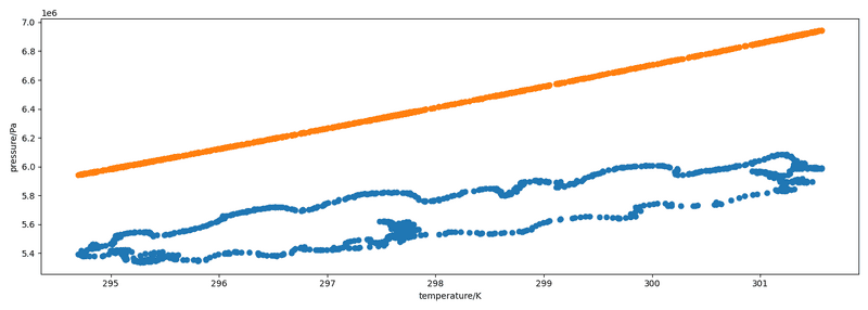

I have posted a plot of only gas/vapour in post #39, but I can also upload plots in this post as well.

Since the temperature keeps dropping slightly, I assume it's discharging but the pressure is not changing.
In my interpretation the dropping temperature is caused by the daytime (evening) and maybe the pressure does not follow, because the atmospheric pressure increased at that time. Btw I could also get a time series of the atmospheric pressure, but from another room, and then correct the gas pressure for the surrounding pressure.

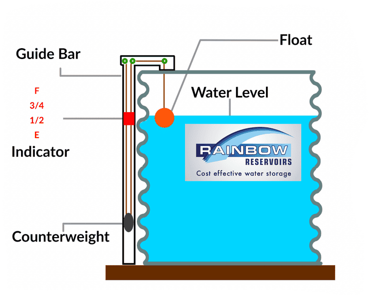

By the way, did you consider the floater or a similar sensor to find the amount of liquid inside?
Yes, but it is not possible.

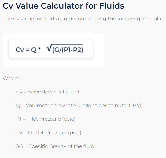

I meant I think you have 3 alternatives regarding the valve.
  1. Measure the flow experimentally.
  2. Characterize the valve and measure the flow indirectly using calculations. Then check the results with your experimentally measured P-T graphs to ensure your results make sense.
  3. Similar to the previous options but without characterizing the valve. You'll have to solve the problem several times assuming different valve characteristics hoping that, for some values for the valve, the results match what your experimental measurements of P-T are reading.
By the way, probably there are books, articles or other webpages covering the characterization of valves in more detail or in more convenient units (those 816 and 962 might be converting factors but I don't really know it).

I have tried to compute the differential equation by @Juanda in the attached image, but for a pure CO##_2## gas: ##\dot m = \frac{\dot q -c_V \dot T}{c_VT - h_\mathrm{out} -q}m##
It starts out well, but somewhere seems to be an error and the mass jumps around 0. What seems strange to me is that the specific enthalpies and internal energies are below zero. I get those from the Python package pyromat.
Edit: Found the implementation error. The ode should now be computed correctly, but the result is still implausible.
