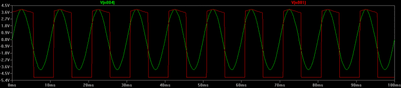

Just to show you a quick simulation of the shown circuit (caveat: I was using an op-amp with only ±6V supply voltage and an input signal of 100Hz AC). The green signal is input, the red is output.
Simulator plot of two voltages against time from 0 to 100 ms: a green sinusoid with peaks near 4V and troughs near -4V, and a red square-like wave switching between about +4V and -5.4V, with the red edges lagging the green peaks.
That data is purrty data man. If you don't mind, can you point out what is not right about it?
xconwing said:
So my initial thought was correct, whichever input is active will classify the op amp type? That is to say:
signals going through non-inverting input will make that op amp "non-inverting" and vice versa.
Providing it really is a proper amplifier, yes.
What if they both active?
One will dominate. But usually the circuit will involve frequency-dependent impedances (capacitors, etc), so the sign of the gain may change from + to - over some part of the usable range, and have a phase somewhere in between for most of the intermediate range.
The output waveform doesn't resemble the input sinusoid! So not an "amplifier" in the ordinary sense of the word. The output is not linearly related to the input.

Svein's 'scope trace in post 8 shows Schmitt Trigger action quite nicely.

Yes - it is a so called "Schmitt trigger". Watch the hysteresis effect (output goes high at another level as it goes down again).
Warning: One should know that some simulation runs do not reveal the unability of the circuit to amplify. For example, doing an ac analysis you get a result which looks quite "normal" (as expected).
However, you should not blame the program in this case. The result is quite correct.
Why? Because this analysis assumes (a) that the circuit was powered since infinite times (without switching transients) and (b) that there are absolutely no external influences (noise, temp. variations) which would disturb the quiescent conditions.
You must do a TRAN analysis (time domain) to show that the circuit cannot work in a linear mode.
This case is similar to the mechanical model of two balls - one riding upon another one. Under ideal conditions this arrangement could also be stable.

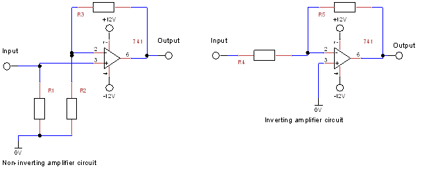

Just to show the basics:
Two op-amp circuit schematics side by side: left is a non-inverting amplifier with resistors R1, R2 and R3 and input on pin 3; right is an inverting amplifier with resistors R4 and R5, input on pin 2 and pin 3 grounded to 0V. Both use a 741 op-amp with +12V and -12V supplies.
Non-inverting circuit:
  • Gain = 1 + R3/R2
  • Input impedance: R1
Inverting circuit:
  • Gain = -R5/R4
  • Input impedance: R4
