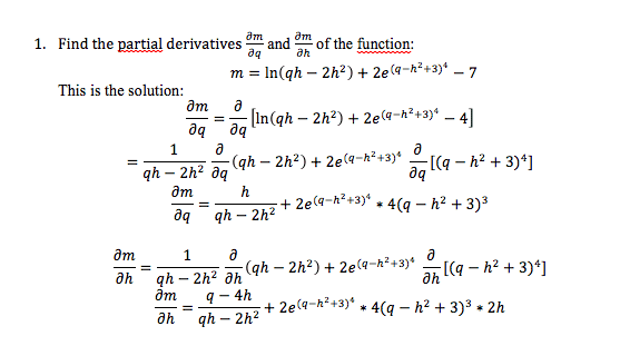

Kamo123 Messages 5 Reaction score 0 Thread starter Nov 7, 2015 #1 Hello Is what I have done calculated here correct? Please correct me if I have done something wrong. Thanks in advance. Attachments pp1.png 11.6 KB · Views: 566 pp2.png 10.7 KB · Views: 538

mathman Science Advisor Homework Helper Messages 8,130 Reaction score 575 Nov 7, 2015 #2 You have the fundamentals correct. I haven't gone over line by line for pp2. pp1 looks fine.
Nathanael Homework Helper Messages 1,650 Reaction score 246 Nov 7, 2015 #3 In the last line of pp1, it looks like you've forgotten the factor of negative one that comes from ##\frac{\partial}{\partial h}[(q-h^2+3)^4] ##
