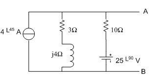

Find the Thevening Equivalent Circuit for the following circuit:
Circuit schematic with a 4 L45 A current source on the left feeding two parallel branches: a 3 ohm resistor in series with j4 ohm inductor, and a 10 ohm resistor in series with a 25 L90 V voltage source; terminals labelled A and B.
KVL, KCL.
First of all, I calculate the current in the middle mesh, which I'll call i2:
[tex]- j25 = ({i_2} - {i_1})(3 + j4) + {i_2}(10)[/tex]
where i1 is the current defined by the current source. Once I've got i2, I multiply that by 10 to get the voltage in the 10 ohm resistor, and after that I calculate Vab using:
[tex]{V_{ab}} = j25 - 10({i_2})[/tex]
However, the result is incorrect (should be 22,2 V with a 98º angle). What am I doing wrong? I've used the same method with other circuits and it worked just fine.
You'll have to show your work. Using your technique I reached the correct result.
