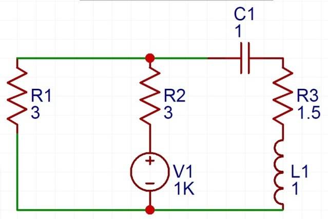

I need to find the Thevenin Resistance and the Thevenin Voltage
Vth =Rth I (Short Circuit)
I know the answer is supposed to be Rth = 3Ω and Vth = 0.5V, but I couldn't get there with my method.
I only get the Rth to be 3 Ω if I first find the parallel equivalent of the two 3 Ω resistors and then have that be in series with the 1.5Ω resistor. If I try it the other way around though ( have the 1.5Ω resistor be in parallel with the 3Ω resistor, I get a different answer of 4 Ω.
Also I don't really understand how the Thevenin voltage would be found in this case as observed by the source because won't the absence of the voltage source cause the Vth to be 0V?
Help on this matter would be very much appreciated.
Since you have not indicated the 2 nodes at which the Thevenin equivalent is to be taken, this is an incomplete problem statement and thus has no solution.
Is that voltage source 1V or 1000V?
Perhaps L represents the load, rather than an inductance?

Sorry about that, I rebuilt the circuit in a simulator and didn't see that 1K looming by the source. The voltage source is 1V.
I rebuilt the circuit in a circuit simulator, the problem stated that L1 was an Inductor. Rather L1 was a series of inductors that was supposed to be simplified.
You would get your answer if L were to be regarded as the load, so I suggest you do that.

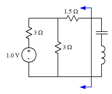

The 1.5-ohm resistor isn't in parallel with the other resistors, so analyzing the circuit as if it were in parallel with the 3-ohm resistor is pointless and misguided.
You can redraw the circuit, moving some of the components around a bit without changing the behavior of the circuit. In particular, isolate the resistor network from the reactive load components and make the voltage divider nature of the resistor network more obvious:
Take the Thevenin equivalent where the blue arrow divides the source and resistor network from the reactive load components.
