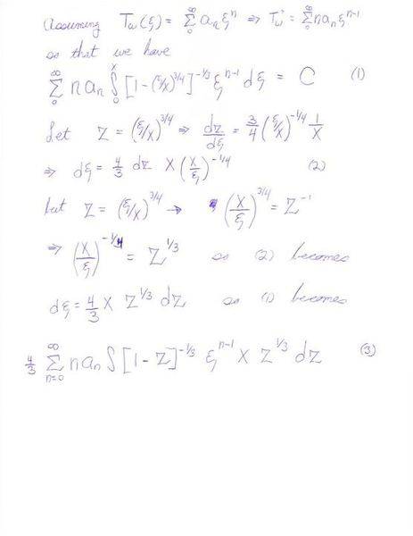

I like Serena. I am going through your substitution since mine is not working out. I am curious about a few things though. I'll start with one: since we defined [itex]u = 1 - (\frac \xi x)^{3/4}[/itex], it woud seem that assuming [itex]T_w (u) = \sum_0^\infty a_nu^n[/itex] is not the same as assuming [itex]T_w (\xi) = \sum_0^\infty a_n\xi^n[/itex], is it?
I have tried the following for now and have reached an impasse. I still have x's and xi's in my integral that I don't know what to so with:
You didn't finish the substitution.
There's still a xi in the integral that needs to be replaced.
Furthermore, boundaries of your integral have changed to [0, 1], meaning x is no longer part of the integral, which means in turn that you can move all x out of the integral.
In other words.
From your definition of z follows:
[tex]\xi = x z^{\frac 4 3}[/tex]
Substituting gives:
[tex]\frac 4 3 \sum n a_n \int_0^1 (1-z)^{\frac {-1} 3} (x z^{\frac 4 3})^n x z^{\frac 1 3} dz<br /> = \frac 4 3 \sum n a_n x^{n+1} \int_0^1 \frac {z^{\frac 4 3 n + \frac 1 3}} {(1 - z)^{\frac 1 3}} dz[/tex]
