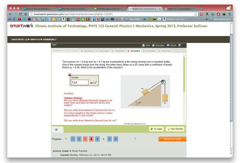

Two masses m1=3.2 kg and m2=4.7 kg are connected by a thin string running over a massless pulley. One of the masses hangs from the string , the other mass slides on a 35 degree ramp with a coefficient of kinetic friction uk= 0.30. What is the acceleration of the masses?
I used 9.81(4.7-3.2[0.3cos(35)-sin(35)]/(3.2+4.7)=7.13 but its wrong
Sneakatone said:
I did (9.81(3.2sin(35)-3.2cos(35)(0.3)+4.7))/(3.2+4.7)=7.13
and it is wrong
No, it gives -6.46, i.e the masses accelerate in the other direction.

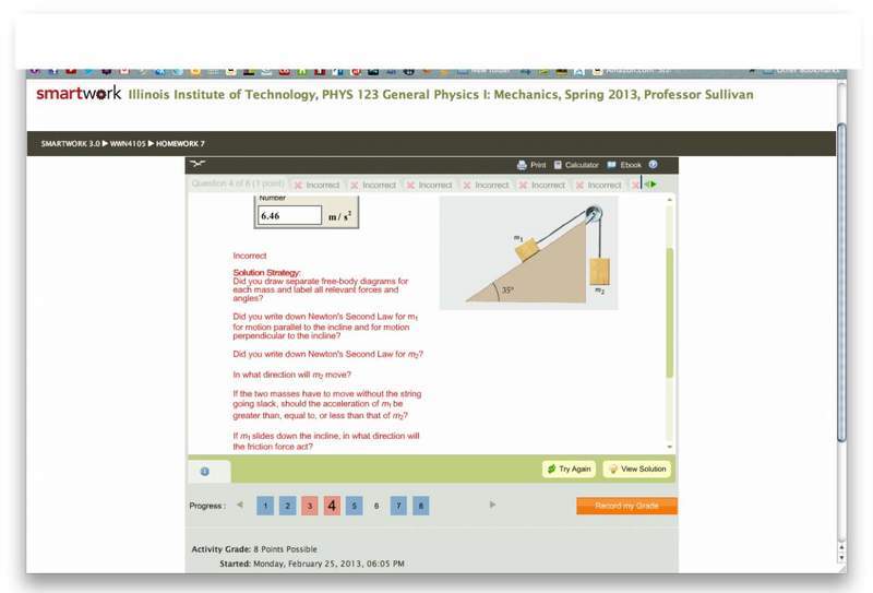

and it is wrong
You have a sign wrong. Think about which way the forces on m1 parallel to the ramp act.
I switched cos with sin n I got 8 which is wrong
Wrong correction. List the forces acting on m1 parallel to the ramp. What are their magnitudes? Which ones act in the direction of acceleration and which oppose it? What does that make the net force producing the acceleration?
