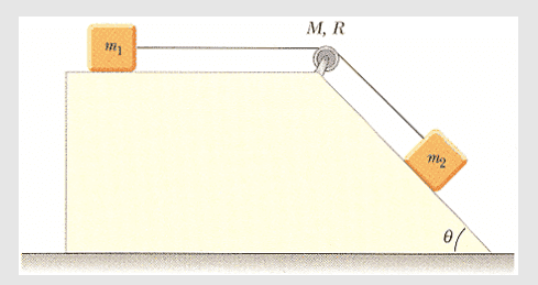

A block of mass m1 = 2 kg and a block of mass m2 = 6 kg are connected by a massless string over a pulley in the shape of a solid disk having radius R = 0.250 m and mass M = 10 kg. The fixed, wedge-shaped ramp makes an angle of 30 degrees and the coefficient of kinetic friction is 0.360 for both blocks. Determine the acceleration of the two blocks. The only part of this problem that i don't understand is how to get the forces acting on the object:
T1 = μm1g+m1a
T2 = m2gsinθ−μm2gcosθ−m2a
I know you have to divide it into the sin and cos components but I don't understand why the cosine was used when it is sliding down the ramp. I thought only the sine should be used and that the cos would cancel out with the normal (N). Thanks in advance for any clarification!
  • Diagram of two blocks connected by a string over a pulley at the top of a wedge-shaped incline; block m1 sits on the flat top, block m2 hangs on the sloped face at angle θ, pulley labeled M, R.

Try to visualize it. Think about all the force vectors that are acting on either mass that run parallel to the surface their respective mass is on (I hope that's clear enough). I count 3. It should be easy from there.

I still don't understand why the cosine is used because when I draw out all the force vectors the mgcostheta cancels out with the normal force. :/ Unless I am drawing my force diagrams wrong.
Yes, the normal force is equal and opposite to the component of gravity normal to the plane, i.e. mg cos(θ). Why is that a problem? How do you obtain the kinetic friction force from that?
This is the answer for the tension from my solution manual: T2 = m2gsinθ−μm2gcosθ−m2a
So if the cosine cancels out, my question is why does it still appear in the equation?

It only cancels out in the sense that there is no net force normal to the plane. But the friction is not related to the net force. It depends on the normal force, which is not zero.

T2 (I think you mean) is parallel to the plane. It has no component normal to the plane.

W2cos(θ).

T has a vertical component Tsin(θ) (opposing) W. T=Wsin(θ), so that component is Wsin2(θ). Take that from W leaves Wcos2(θ). Likewise, N has a vertical component Ncos(θ) opposing W. Conclusion, N=Wcos(θ).
Since there is acceleration, it is much easier to analyse in the directions parallel and normal to the plane.

T has no component in the N direction.
I agree (finally) with that and that the value of N (the normal force) has to be N = M2 g cos theta.
