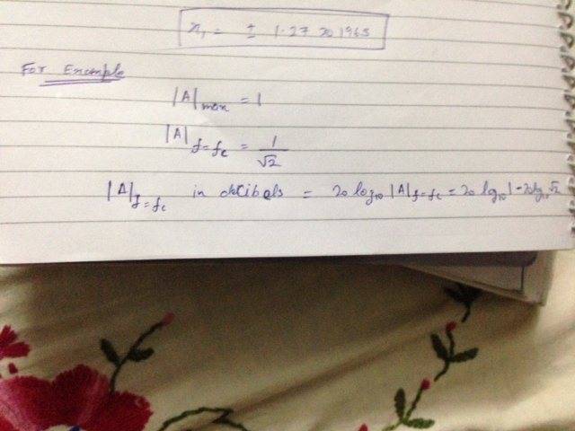

-3db point is called as the cutoff frequency or half power frequency. It is a frequency at which magnitude of gain decreases by 3db from maximum gain.

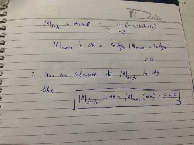

Does it mean that I shouldn't multiply the maximum magnitude by 1/sqrt(2) but subtract 3dB?

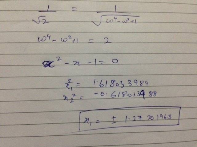

I meant about the frequency values.
I did it roughly .

You can subtract 3 db only when the magnitude is also given in decibel .

I did it roughly .
I got the same answers and finally found out what I did wrong. Thank you so much!
But only the +1.27 is a valid frequency, right?
That depends on how pedantic your instructor is. You can interpret the real-valued signal ##\cos(\omega t)## as a complex-valued signal:
\cos(\omega t) = \frac{e^{j \omega t} + e^{-j \omega t}}{2}
with frequency components at ##-\omega## and ##\omega##, but I doubt that makes any difference for your assignment. The negative frequency components are redundant if you're only working with real-valued signals, so I think you can easily argue that it's correct to only include the positive frequency component in your answer.

Got it. Thanks!
