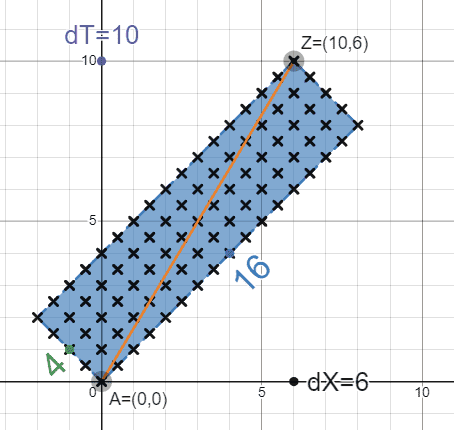

The level hypersurfaces ##x^2 +y^2 +z^2 -(ct)^2=Q## (where ##Q## is real) are hyperboloids.
In a (1+1)-Minkowski spacetime, ##x^2-(ct)^2=Q## are hyperbolas.
(##Q=0## is the light-cone at the origin event, and
The future-branch of ##Q=-1## is a visualization of the metric tensor.)
As Minkowski suggests (see my post in orthogonality-in-minkowski-spacetime-meaning-visualization ), the hyperboloid plays the role of a "sphere" (a "circle" in 1+1) by providing a "metric" to assign numbers to displacements and to define "orthogonality" in that geometry, which encodes the speed of light principle and the relativity principle, as well as "effects" like time dilation, length contraction, and the relativity of simultaneity.
While thinking in terms of hyperbolas is important (in order to understand the "metric"),
I found that it is also helpful [in the (1+1)-case] to visualize and think in terms of
"causal diamonds" and "light-clock diamonds" (based on light-cone coordinates [the eigenbasis of the boost])
because the "area of the diamond (in units of light-clock diamonds)"
is equal to the "square-interval along its diagonal"
(see my PF Insights:
https://www.physicsforums.com/insights/spacetime-diagrams-light-clocks/
https://www.physicsforums.com/insights/relativity-rotated-graph-paper/
https://www.physicsforums.com/insights/relativity-on-rotated-graph-paper-a-graphical-motivation/
and
https://www.desmos.com/calculator/4jg0ipstya
described in https://www.physicsforums.com/threa...le-go-through-spacetime.1048187/#post-6832310 )
