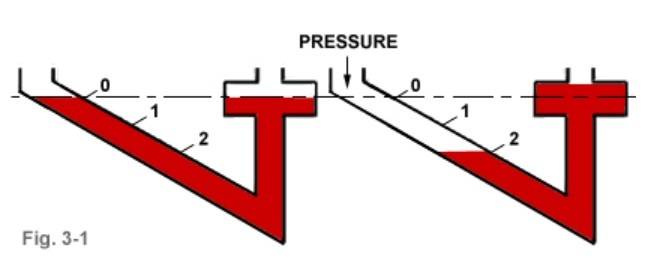

You could get close to your desired accuracy with an inclined tube water manometer. Dwyer Instruments has a good discussion of these: https://www.dwyer-inst.com/ApplicationGuides/?ID=11. This diagram is from that link:
200 Pa is about 20 mm of water column, so 0.1 Pa would be 0.01 mm water. Multiply the water displacement by 10 for a tube inclined at 5.7 degrees. Note that the diagram is slightly misleading - you need to measure the water level change horizontally, not vertically. Measuring to 0.1 Pa is unrealistic, but you might be able to measure to 0.5 Pa. And the possibility of a good lecture about how measurement accuracy sets the minimum velocity in the wind tunnel.

If I choose alcohol and 5 degree inclination, so I need 0,15 mm water displacement. Here is my calculation:
$$P_A = (\rho)(g)(d sin \theta) + P_B$$
So, differential pressure between leftside and right side is:
$$\Delta P = P_A - P_B = (\rho) (g) (d sin\theta) $$
For alcohol, the density is ##\rho = 789 kg/m^3## and for ##\theta = 5\deg##. Using ##g = 9,81 m/s^2##I get:
$$d = \frac{P_A - P_B}{674.59 kg/(m^2 s^2)}$$
Is my model true?
But, How can I measure 0.15 mm water displacement? Could I use camera analysis?

Well, I decided to try the inclined manometer for my instrument. Do I need to calibrate the manometer? I mean, how I believe my instrument measure air pressure accurately?
Manometers are inherently accurate, so can be used to calibrate mechanical pressure gauges and electronic pressure sensors. An inclined manometer is as accurate as the sources of error:

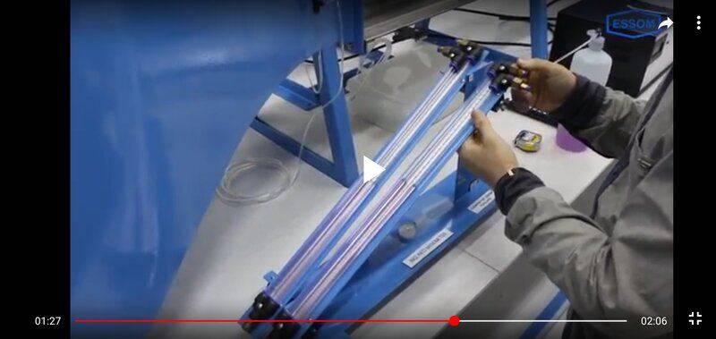

Guys, after a few trial, I decided to use simple U tube manometer as an inclined manometer. I used oil as working fluid which has ##\rho = 890 kg/m^3##. The angle between oil column and horizontal approximately as large as 4 degree. Theoretically, the oil surface will drop because P outside (connected to column under) is bigger than P inside wind tunnel. But, I didn't observe any oil surface movements. What do you think I can do to improve this simple instrument? Thanks.
I placed my manometer under the wind tunnel. Does the location of manometer from propeller affect the measurement?

Stepwise refinements.
In the post #15, upper picture, it looks to me like you have a bubble in your liquid column. The column must be bubble free in the loop.
You have mounted the 'U' loop on the vertical plane. I would have mounted it on a horizontal surface, then tilted the surface by about 4°.
I'm not sure of your material, if the tube was hard and straight, like acrylic or glass tube, there would be less wandering error in the reading scale.
If you can use a fitting to reduce the radius of curvature, the two legs can be closer together, that will reduce the reading error. Place the tubes right next to each other, not separated by the width of the scale.
Rather than a thick clear oil, consider using an alcohol or kerosene that will flow faster and accept a strong coloured food dye.

Which bubble do you mean? Does it located beside the 9 scale?
My U manometer is made from glass, like another standard laboratory equipment. Therefore the two legs is stiff and can't be moved closer to each other.
Well then, I will try to place the manometer on horizontal plane and tilt it 4 degree.

Yes, there is liquid between 9.0 and 9.6; The bubble is between that and the main liquid.
A manometer is not calibrated if there are bubbles in the liquid.

One more, I think if the manometer is on horizontal plane, there will be a difficulty to take the picture. What should I do if the manometer is still on vertikal plane?
Experiment with many alternatives.
You will have several manometers all in the same picture.
Keep one manometer disconnected, so it can act as a level reference and control.
How many manometer do I need? 3? 2 manometer connected to the object and 1 as reference?
The closer you can get the camera to the tubes, the better the pixel and pressure resolution.
That suggests all tubes should be close together. The best way to do that is to have camera axis close to vertical with all tubes parallel, on a sloping surface.
You must have some way to identify the horizontal and zero pressure in the picture. Place the two reference manometer tubes in the outer positions to give a good estimate of cross-slope.
How many cameras will you use?
How will you make measurements from the pictures?
Will you count pixels?
i think I just use 1 camera (phone's camera) and using picture analyzer like Tracker.
What is sloping surface? What is cross slope? Sorry I don't understand.
An inclined plane or a ramp. https://en.wikipedia.org/wiki/Inclined_plane
When the manometer is placed at an angle on the inclined plane.

Ohh i see. So, if I use a ruler beside the column and the ruler is parallel with horizontal line, can I use the vertical one? Then I need to place two manometer close each other?
I prefer vertical one because I still don't understand the hydrostatics prinsipal in the ramp manometer. Do you have any idea about this? Or literature.. thanks again
You must search 'manometer' and 'hydrostatics'.
Until you understand what you are doing and the principles of how it works, you will be unable to measure small differences of pressure.
