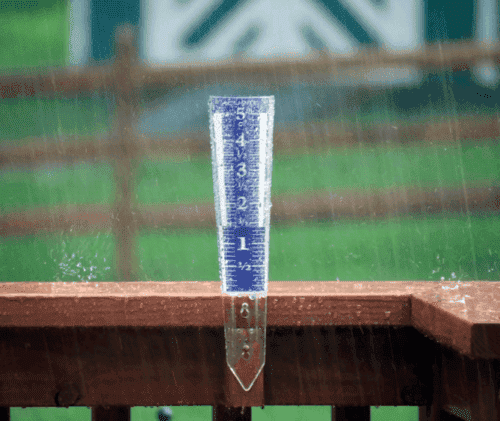

Look up Rotameter,
basically a weighted float in a vertical tapered tube that's lifted by velocity of water.
It should be self cleaning because clearance gets bigger as you go up.
Tapered tubes are sold as rain gages.
240897
but you have to measure how high is the float in the tube ...
