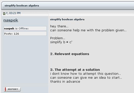

hey there..
can someone help me with the problem given..
Problem..
simplify b ⊕ c'
i don't know how to attempt this question..
can someone can give me an idea to start..
thanks in advance

What was the symbol between b and c'? Kind of hard to help if we don't know what the problem is.

It looks like an exclusive OR to me, as in 'one or the other but not both':
A B X
0 0 0
0 1 1
1 0 1
1 1 0
So A XOR B = A'B + AB'
So what does that tell you about B XOR C'?

thank u for the such an idea..
so..
when A XOR B' = AB + A'B'
correct?
Yes, you can algebraically replace each B with B', so A'B + AB' becomes A'B' + A(B')' = A'B' + AB.
