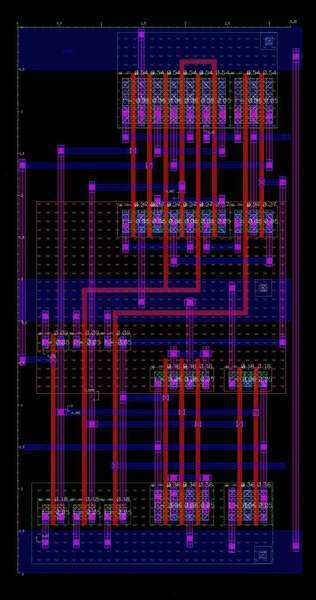

It's an SR NOR latch - the schematic is shown at this site. Are you familiar with MOS transistors at all? If not, this youtube tutorial should explain the basics. In this layout, the following colors are used:
Red - Poly gate
Orange - P+ Diffusion
Green - N+ Diffusion
Blue - Metal-1
Filled Aqua squares - contacts that connect the Metal-1 to the poly and diffusion layers.
Try tracing out the layout and matching it to the schematic of the SR latch. If you have more questions, ask!

Phyzguy is right. This latch would be used, for example, as the sense amp in an SRAM.
Tracing it out is the way to go. Start by following the gates (red lines) and see where they cross diffusions to create transistors. Keeping in mind that two devices often share a diffusion.
Also, the dotted blue line around the top devices is a N-Well. This is a p-substrate process (I know that because the nmos devices on the bottom of the layout are implemented in the substrate and not in a well).
The square near the VDD label is a well contact and the square near the GND label is a substrate contact. These are needed to reduce the resistance between the circuit and the well/substrate to mitigate latch-up.
Good luck! This is a good circuit to get started on!

@phyzguy :) yep i know about mos ... but i am not familiar with layout designing :( i know the basics but i don't know how to back trace it ! let me go through the materials u provided and then i will ask again..
@analogdesign :: i absolutely second you :) tracing is the way.. but that's where i am weak at. i am learning..
can any of you please show me the transistor design ?? just simple handsketch will do. so that i can compare with this layout..

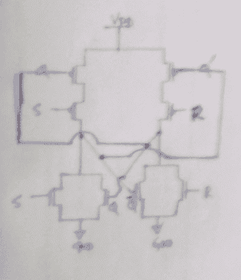

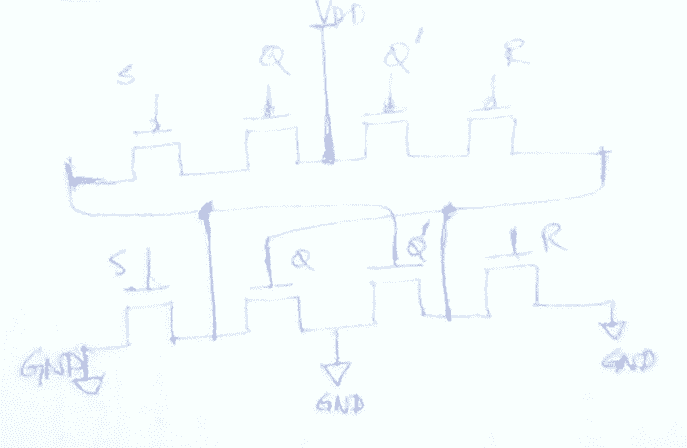

here is what i was able to figure out of the circuit ... can you guys have a look and tell me whether i am right or wrong?? the PUN is of pmos and PDN is of nmos.. sorry for the bad sketch.. :(
analogdesign
- 1,150
- 370
I think you got it! Good job. Try to draw it a bit more in the standard way and how it works will be more clear to you.

Looks good to me, too. You might try learning how to use a schematic editor to draw the schematics. There are several free open-source ones to choose from.

analogdesign said:I think you got it! Good job. Try to draw it a bit more in the standard way and how it works will be more clear to you.
:) if its not a big trouble then can u please show me the standard model of it ? i want to compare and learn .. a hand drawn one like me will be good enough...
EDIT: please have a look at it.. is this how the standard diagram should be?

dafaq said::) if its not a big trouble then can u please show me the standard model of it ? i want to compare and learn .. a hand drawn one like me will be good enough...
Looks good! You got it.

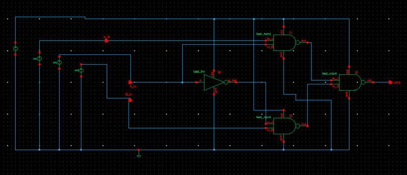

i have attached the screenshot of my 2:1 MUX using 3nand and 1inverter. now , i am quoting the exact question "The circuit given has three inputs. Both the delay and power consumed by the circuit
depends on the input pattern you apply at the input. What is the worst case pattern for delay?
For power?" ---- i am absolutely confused... if you guys could help me then it will be really great..

analogdesign
- 1,150
- 370
Hi dafaq,
I'll give you two thoughts. First, for delay, look at your circuit and think about the paths the signals have to go through. If S_IN switches, for instance, to get to the output the signal has to go through the inverter and then the NAND gate i2 and finally the NAND gate i3. So it must propagate through an inverter and two NAND gates. If S_IN is constant and A_IN changes instead, before the output changes the signal must go through I1 and I2 only. Do you see the difference? The delay from the A_IN input to the output is less than S_IN to the delay. Therefore, patterns that do not include S_IN switching will be faster (they will have less delay).
As for power, a CMOS gate ideally only consumes power when it is switching, so this is similar to delay. THe patterns that make the most gates switch their states will consume the most power.
In practice, your standard cell library documentation would have typical and worst case delays for different temperatures and you could add them up to find the worst case delay for your mux. The documentation would have similar information for power.

The trick about power is that some patterns will glitch the output when the selector switches (depends on the input state), thereby consumming extra power because of the extra switching. I'll let you discover the pattern.

@both big guys :: considering the delay -- umm.. as far i know - multiplexers are used to select the input lines only. the input values are already available in the input ports and we don't really change them, we just vary the select patter (S) to check which input will go to the output. in my diagram, let's assume i have 0 in A and 1 in B and the S' is connected to the bottom NAND gate. if i assume logic 1 is true and s'=0.. in that scenario if i want to select line 1 for the output then i will simply provide 1 as select value and if i want line 2 for output then i will have to change select value to 0 so that s'=1 and the lower NAND is active. so how i see is - my worst delay will be then when i am to use the network which contains more number of logic elements. am i right? so the worst delay patter will be when i switch my select from 1 to 0 for selecting the lower input as the final output of the mux. is my answer correct?
meBigGuy
- 2,325
- 406
The longest path is certainly the path through the inverter, but whether H-L or L-H is the slowest depends on the characteristics of the gates (H/L vs L/H propagation) and the input values.
analogdesign
- 1,150
- 370
Also, multiplexers are used a lot of different ways. In some logic styles the select input is used as a data input, so taking it into account is important.
meBigGuy is correct about the non-symmetric rise and fall times of CMOS logic.

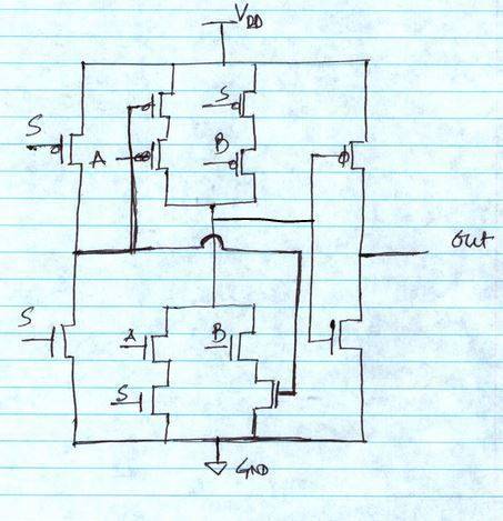

:) thanks to all of you for the last question answers... i did find the pattern of input that will cause the worst delay..

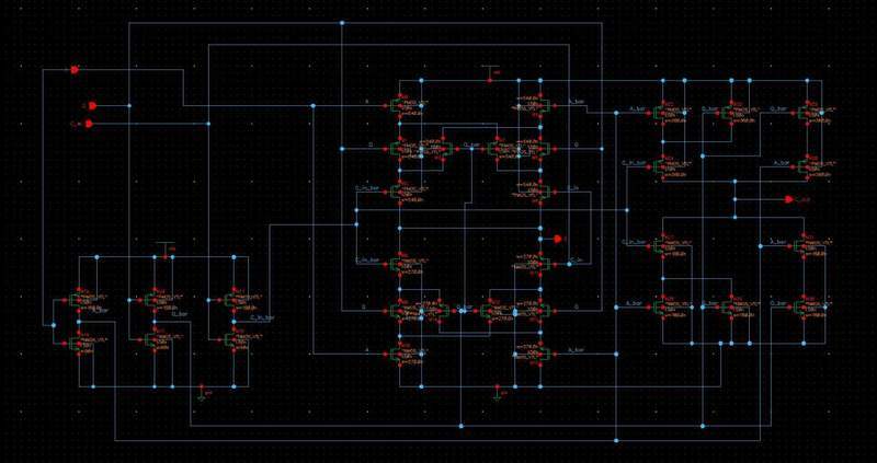

here i am back again with something similar to this thread, i need help understanding this layout..
what is it implementing? i will try to iterate like last time and finally get to the schematic level diagram (like S-R NOR latch) i am a bit confused, since so much turning and so many contacts !

phyzguy
- 5,292
- 2,363
dafaq said:bigguys :) here is my first input, please correct me if i am wrong ---
This looks right. Note that the two transistors on the left are an inverter, so they generate Sbar from S. The two transistors on the right are an inverter that buffers the output. So what do the 8 transistors in the middle do? What happens when S is high? What about when S is low?
