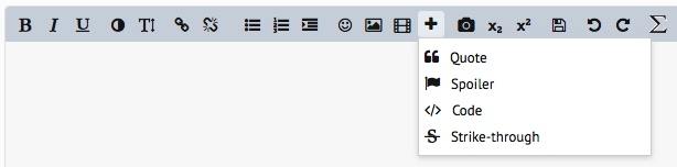

Lordy.
If you want us to debug your code for you, for heaven's sake please
  1. Use CODE tags
  2. Indent
  3. Maybe even toss in a comment or two

I didn't find any CODE tags options in comment section, @fortran90 @ubuntu @arrays @realindex​
This is what we are talking about:
