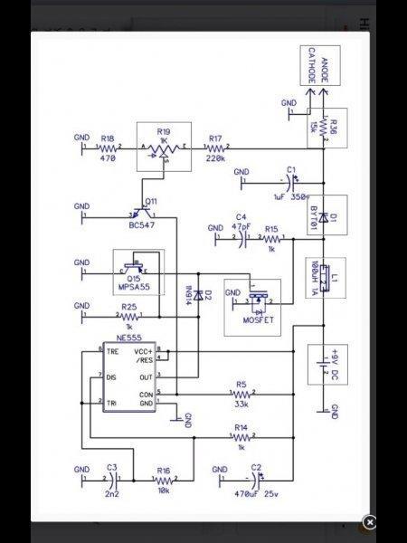

Also, any ideas on making a 2Mohm potentiometer that can dissipate 50W? I was thinking using something like a dc motor as a 'dump load' but I don't know if anything could really take the 10Kv that would be going in.
Can you post the schematic for your 9V to 300V boost circuit? That sounds like a good background for the PSU you are wanting to build now.
You generally wouldn't use a potentiometer to give you a variable output for a PSU. Instead, you build a switching boost power supply that can vary its output voltage. And you can incorporate some of the HV boost ladders that it sounds like you have been looking at.

Hi, thanks for the reply, the reason I was thinking of using a potentiometer/potential divider circuit was so that I could also drop the output amperage to about 5mA, which would be painful, but not too dangerous (relatively speaking) to be shocked with. Since the value of whatever resistor I used to do this current drop was going to vary with the voltage, I though I may as well use it for that purpose at the same time. Is there a way I can just limit the maximum possible current that can pass through a section instead (probably would be placed on the ac in side, before being stepped up) or another way of achieving this same current limit?
I have included the psu design for the Nixie tubes (from instructables) however I don't think that it would scale up to well and I already have had great difficulty in finding a mosfet rated for for voltage this one would be dealing with.
The 2MOhm resistor would limit the current to 5mA if you use the full resistor as series resistor - but then you cannot use it for voltage regulation.
If you use it as potentiometer, it does not work as hard current limit.

I feel like I'm missing something here, isn't it that for resistors in series the same current is across each if them and found through V=IΣR therefore, if there are two resistors, and they total to 2,000,000 ohms, that it would limit the current across them both when a 10Kv potential is applied to 5mA and then the voltage output at 5mA would be R(second resistor)/total resistance?
What am I missing and how else could I accomplish this?
A brute force 10KV with resistance current limiting would be dangerous, that high voltage is just waiting to break out through your resistor and ...
I'd think you might want a more modern design, some sort of flyback converter that'll be inherently current limited.
