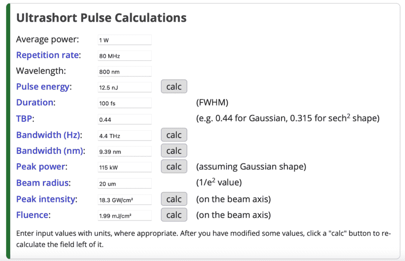

(wavelength 800nm)÷(bandwidth 9.39nm)≈85
I utilized an Ultrashort Pulse Calculator on a website (https://www.rp-photonics.com/ultrashort_pulses.html) and got the bandwidth of 9.39nm with the specifications listed above.
Then divided the wavelength by the bandwidth, and it came out 85(optical cycles).
However, I am not sure if it is the way to calculate the optical cycles in a laser pulse.
I only had an idea that ultrafast lasers, such as femtosecond laser, generate few-cycle pulses.
Would someone here be so kind as to offer some guidance on this question? Thank you!

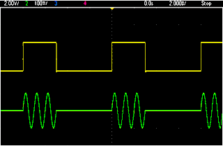

You need to apply the basic physics of waves, In particular you need to be familiar with the formulae ##T=\frac1f ##and ##v = fλ## (or ##c=fλ##). Have you met these? Assuming you have...
An ‘optical cycle’ is one full oscillation of the wave in the question.
The time taken for one optical cycle is the period, T, of the wave.
The number of optical cycles per second is the frequency, f, of the wave.
Here are some questions for you to work through. Post your working and answers.
The wavelength of an electromagnetic wave is 800nm (in a vacuum or, near enough, in air).
Q1. For interest, in what part of the EM spectrum is the wave?
Q2. Calculate the wave’s frequency in Hz.
Q3. Calculate the wave’s period (i.e. the time for 1 optical cycle) in seconds.
Q4. What is the wave’s period (i.e. the time for 1 optical cycle) in femtoseconds?
Q5. If each pulse last 100fs, how many optical cycles are there in each pulse?[Edit - minor changes.]

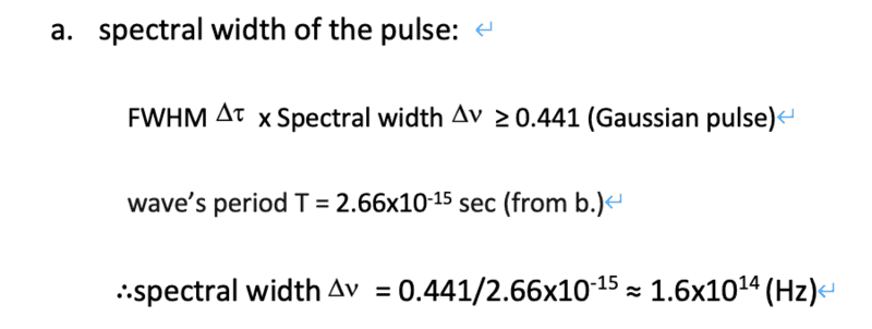

The "spectral width" of the pulse is how uncertain we are about a measurement of the frequency of the signal during a pulse. It tells us how smeared out our measurements would look when plotted against the electromagnetic spectrum.
It is not measured in units of distance (micro-meters). It is measured in units of frequency (Hertz).
I do not know if the chapter you are working on goes into Fourier analysis, so let us ignore that.
One way of thinking about the measurement is that you are counting wave peaks. You have this wave form that is chopped off at the ends. You count peaks and you get 37. Or maybe you get 38. That is how fuzzy your measurement is. So what is the frequency associated with 37 peaks per pulse? And what is the frequency associated with 38 peaks per pulse? That is an approximation for the frequency range of your measurements.
Another, somewhat more accurate way of thinking about it is that your measurement process will involve something like a resonator. If you only have 37 cycles of signal to resonate with, a signal that only gets one quarter cycle off over the course of those 37 cycles will still excite your measurement device.
However, I've been out of school a long time and we never covered this material. So I do not know whether you are expected to throw in a divisor of ##\pi## or something similar when you calculate the spectral width of a truncated signal.
Likes rinalai
rinalai said:
0.3µm/fs is the speed of light c=3x10^8 m/s= 0.3µm/fs
100fs x 0.3µm/fs = 30 µm (sorry that I mistyped)
Is this the spectral width of the pulse?
No. You have simply calculated how far the (infrared) light travels in 100fs (distance = speed x time).
rinalai said:
Besides, I think the pulse-shape was a Gaussian pulse.
Should I go for FWHM in this case?
Have you posted the full question? The shape of the pulse can make a difference.
In addition to what @jbriggs444 has said, here are a few facts which might help:
For a rectangular pulse of duration τ and carrying energy E:
- peak power is Pmax = E/τ; it is the same as the average power during the pulse;
- optical bandwidth in terms of frequency is Δf = 1/τ.
For a Gaussian pulse with FWHM = τ and carrying energy E:
- peak power is Pmax ≈ 0.94E/τ
- optical bandwidth in terms of frequency is Δf = 0.44/τ.
I got some of the information from memory and some from https://www.rp-photonics.com/gaussian_pulses.html so can’t guarantee accuracy. You should check your notes/text-book to make sure you are given these (or equivalent) formulae.

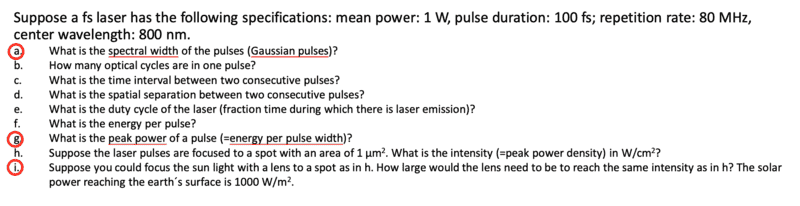

Here is the full question:
The circled ones are those I am still trying to figure out :oldeyes:
For question-a, what formula are you given (in notes or textbook) for spectral width?
Note, 'spectral width' and optical bandwidth are basicaly the same. The former would usually be expressed as the spread of wavelength and the latter would usually be expressed as the spread of frequency. It is not clear which (wavelength or frequency) you are being asked to find – you will need to refer to your notes.
______________
For quesion-g, there is a mistake in the question. It asks for peak power (of a Gaussian pulse). But then says ‘energy per pulse width’ which means average power.
You will have to decide which (peak or average) is actually required. If the work is to be handed in, give both answers with an explanation. See my formulae in Post#16.
______________
For question-i you need the answer from question-g. If the radius of the lens is R, what is its area? Write an epxression for the sunlight power collected by the lens and equate it to your answer to question-i. Then solve for R.
Likes rinalai

Thanks, Steve4Physics, for your kind comments.
Here is my answers and the professor's feedback(in italic):
1.6x10^14(Hz) corresponds to 9.4 nm
g. Peak power is pulse energy per pulse duration: 12.5 nJ/100 fs = 125 kW
h. Focus is the same as in h. So we want 125 kW from the sun.
Since we get 1 kW/m^2, we need an area of 125 m^2
Hi @rinalai.
I believe your answer is wrong.
If you have written the professor’s feedback correctly, your professor hasn’t spotted your (serious) mistake and has incorrectly written:
“1.6x10^14(Hz) corresponds to 9.4 nm “
which itself is wrong (though 9.4nm is the correct answer).
Optical bandwidth (##Δν##) is the spread of frequencies required to make a pulse. For a Gaussian pulse:
##Δν = \frac {0.441}{Δτ}## where ##τ## is the pulse-width (100fs); ##τ## is NOT the period (T) of the wave. You mustn’t confuse the two. Please look at the diagram in Tom.G’s Post’6. Make sure you know the difference between a pulse and a wave-cycle.
##Δν= \frac {0.441}{100*10⁻¹⁵} = 4.41 \times 10^{12}## Hz
Spectral width (##Δλ##) is the spread of wavelengths. It can be calculated from ##Δν## using a formula you should have:
##Δλ = \frac {λ²Δν}{c}##
You should calculate ##Δλ## for yourself to see that it giveS the same answer as your professor’s (9.4nm).

Thanks for pointing out the mistake.
Yes, by using the formula
Spectral width= (800x10^-9 m)^2 x (4.41x10^12 sec)/3x10^8(m/s) = 9.4nm
could finally be derived.
Thank you so much for patiently guiding through this question.
