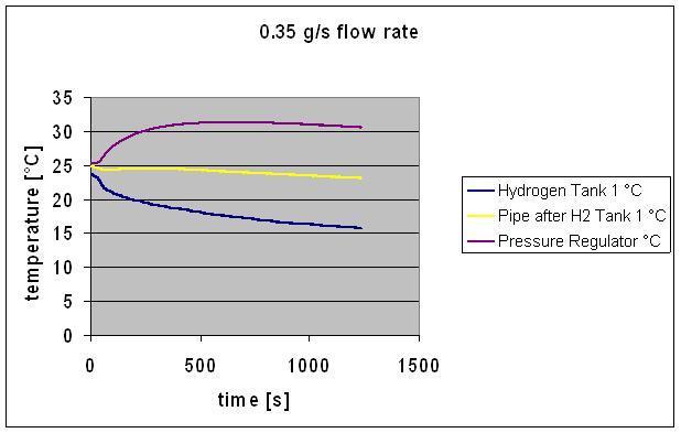

Good morning folks
Sorry for the rather big break.
Just got back some experimental results.
As expected,
1. the tank depressurisation results in cooling of hydrogen
2. the pipe leading hydrogen to the pressure regulator is a bit warmer due to heat exchange with environment
3. the pressure regulator has to some extent free expansion from 300 bar to 10 bar and considering negative joule thompson coefficient for hydrogen, the gas warms up and so does the pressure regulator (ambient temperature is 25°C).
Now as for the simulation, such processes need equation. I have already have good model behaviour for 1 and 2. Now we come to the Joule thompson issue.
I am trying to calculate the resulting temperature given the pressure drop. Joule thompson coefficient u_JT = (dT/dP). Simplifying u_JT=(T2-T1)/(P2-P1)
P1, T1 and P2 are the knowns and T2 and u_JT are the unknowns.
My search for other equations for u_JT lead me to some equations
u_JT= ((2a/RT)-b)/cp (based on van der waals)
Not very satisfactory results. Temperature rise was nominal
Hi hashback,
Note the sudden drop in temperature inside the vessel when dT is small. This is due to the isentropic expansion. The curve flattens out due to heat transfer as dT grows.
The expansion across the valve is considered an isenthalpic (dH = 0) process - and yes, you're correct that temperature for hydrogen increases in this case. Normally, I'd just pull in a value for enthalpy given the upstream state and then take that and pressure to find temperature for the downstream state. You can do this very easily using REFPROP (see post 4). If your company gave you the funding to do the test, you should be able to swing a few hundred for this program. It's invaluable for doing thermo calcs, otherwise you spend too much time just trying to find properties. <bleh>
Couple other suggestions just in case you can't get REFPROP... You might try Perry's Chemical Engineering Handbook or one of the gas handbooks such as https://www.amazon.com/dp/0071358544/?tag=pfamazon01-20paper. Have you done an internet search for properties databases? There are a couple, though the ones I've looked at don't have the right info for you.
