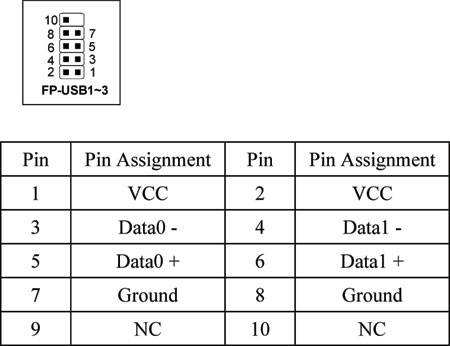

how bout the usb hub that's not wired up on the front should i wire in my usb hub from the other case my acer case?
Completely upto you, it would work perfectly in your new case!
The case does have a usb hub built into the case like my acer does but have no idea about hooking it up :)
The above image may help you. it shows the layout for a USB plug.
also check this video as it shows how to plug in all your front ports from your case to your motherboard (it most likely is a different motherboard and case but they all share the same layout as above)
