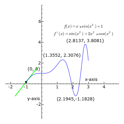

hello!
can anyone add to this excellent animation, the animated graph of the second, third, etc derivative?
Graph of f(x) = x sin(x^2) + 1 in blue, with its derivative f'(x) = sin(x^2) + 2x^2 cos(x^2) shown in the equations at the top; labelled points (1.3552, 2.3076), (2.1945, -1.1828) and (2.8137, 3.8081), with a green tangent line near the origin.
thanks!
