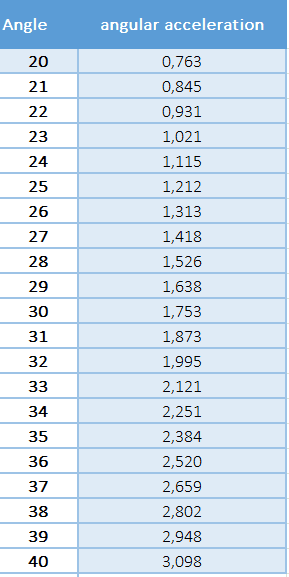

Before doing anything else work out whether your calculated acceleration figure gives you total motion time for the platen consistent with your practical observations .
I used excel to vary the angle and hence get different angular accelerations,
In real life, the anglar speed seems to be contant but I am not really sure how to confirm this since the whole motion is only about 20 degrees and in 1.5 seconds

First of all:
GOOD work with the calculations.
In real life situations, there are resistive frictional forces at every hinge point whose resistive moments have not been considered here.
Also, the actual force output of the actuator is less than the theoretical force given in the actuator manual etc.
One thing i wanted to bring into your concern is that since the angular acceleration is increasing constantly over the range of motion, there will be a "collision" at the end between Hinge at B and the upper most portion of the slot. Over the time, due to constant impact loads on hinge B might be deleterious.

Thank you for your words,
Fortunetly, the collission does not infact happen as the pneumatic cylinder reaches it's maximum length before the shaft hit the end of the slot, so there is no damage there.

I believe there was some simple calculation to find the pressure ,
It is force/area but I am not sure on what area to take ( is it diameter * thickness)?
  • #68
No, actually i was talking about a project i worked on a few months back. Its always better to talk to them ask what all parameters do they require for them to be able to decide for the best bearing.
But yes, generally its Force/Area for deciding the pressure required from the actuator
I don't know about the bearings though. In my opinion it actually depends upon the bearing. In general maximum contact pressure is derived by using hertz law but there are a lot of other factors in play so its quite complicated when designing bearings for practical purposes.
