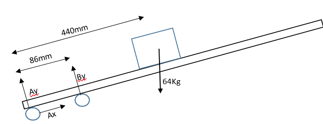

Hello guys,
So I took the part out with the forces in order to find the force B
Using moments about A I get
754 * 0.520 - By *0.12
By= 3267 NThen I used the diagram bellow
And I used the formula
Sum of moment = mr2 * angular accelration
Hence I get
3267*0.086 - 640cos 20 * 0.44 = mr^2*a
754 * 0.520 - 3267 *0.086 = 64 *0.44^2 * a
a= 1.27 rad/ sec and my tested value is approximately 0.7 rad/s2 so I think that this is a good estimate ?Since the angle of the pneumatic cylinder changes as the arm goes up then I assume the force supplied by cylinder is constant

But maybe omarmorocci was taking moments about the mass centre.
Also, it seems to me that Ay and By are forces, not moments.
And I cannot find what omar is using for I.

So does the "main weight" Wp of 50Kg extends over the wood like the figure shows, or is it concentrated at a small region.
From the figure (I suppose Wp is the blue body) it looks like its moment of inertia is that of a rod with length 86+115+230+444
And ofcourse different moment of inertia for the wood (slightly bigger than the blue body) and another for the metal plate, cause each has different length as I see from this figure.
(Sorry if I made you repost the figure)..
The best approximation would be to take the moment of inertia as 64*(0.875^2)/3 I believe that would take you much closer to the result.

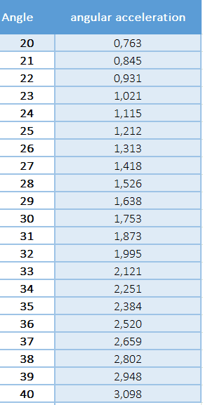

For that I will make an excel document and formula that connects the angle to the torque of the load hence giving me different acceleration.
But for now it's just the initial position,
  • #53
What I am actually also confused about is how to calculate the dynamic load on point A ( pivoting point )
now that I know the acceleration should I just use the following formula
By - Ay - Wt cos tetha = mass * acceleration ?
given eveything is know , I should be able to calculate Ay , which is the dynamic load right ?
  • #54

The problem with that formula is that not all the forces and accelerations are parallel. So it works as a vector equation (if you drop the cos theta) but not as a scalar one.
Choose two perpendicular directions to resolve the forces in (either vertical and horizontal, or parallel to the plate and perpendicular to the plate) and write one equation for each.

I am talking about the tangential acceleration tangential acceleration = angular acceleration * radius
and I am resolving the forces in the direction of the plate and perpendicular to it ( The same as the Ax and Ay)

What you calculated is the angular acceleration ##a##. The acceleration in your equation above should be ##a_y## which is equal ##a_y=0.440a##
But there is also the ##A_x## component of the load which relates to the centripetal force and centripetal acceleration ##a_x## which doesn't relate to the angular acceleration, but it relates to the angular velocity ##\omega## it is ##a_x=\omega^2(0.440)## and it should be
##A_x+W_tsin(\theta)=M_ta_x## , where ##M_t## total mass of 64kg.
The total load will be ##A=\sqrt{A_x^2+A_y^2}##

the static load on each bearing is approx 500 N
and dynamic load is approx 1100 N
the thickness of the sheetmetal is 2 mm
Thanks in advance

Before doing anything else work out whether your calculated acceleration figure gives you total motion time for the platen consistent with your practical observations .
