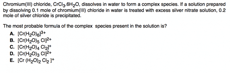

There is 0.2 mol of Cl- ions so therefore this leaves us with a 1:1 ratio for the chloride ion to chromium ion in the complex ion. This leaves us with option B or D. However, I am not sure how to choose between them. Can someone give me some advice?
Cheers!
I don't think there is enough information to choose between the two here.
