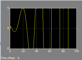

Hello,
I know for a second order process, the tuning parameters are given as ##k_{c} = \frac {\tau_{1}+\tau_{2}}{k_{p} \lambda}##, ##\tau_{I} = \tau_{1} + \tau_{2}##, and ##\tau_{D} = \frac {\tau_{1}+\tau_{2}}{\tau_{1} \tau_{2}}##
Code:
syms s
lambda = 1;
kp = -0.2735;
gp = kp/(s^2+6.035*s+4.146);
[num,den] = numden(gp);
factors = eval(solve(den,s));
tau1 = factors(1); tau2 = factors(2);
kc = (tau1+tau2)/(kp*lambda)
tauI = tau1+tau2
tauD = (tau1+tau2)/(tau1*tau2)
These are my process time constants
Code:
tau1 =
  -0.7906
tau2 =
  -5.2444
This gives my controller parameters
Code:
kc =
  22.0658tauI =
  -6.0350tauD =
  -1.4556
I go into simulink, and here is my model
And here are my PID controller inputs

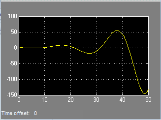

But I haven't figured out why my controller is not working, here is the output
I realized that ##\tau_{D} = \frac {\tau_{1} \tau_{2}}{\tau_{1} + \tau_{2}}##, but still my output is not correct even after changing my ##\tau_{D}## term
I figured it out. My time constants were not correct or in the right form
