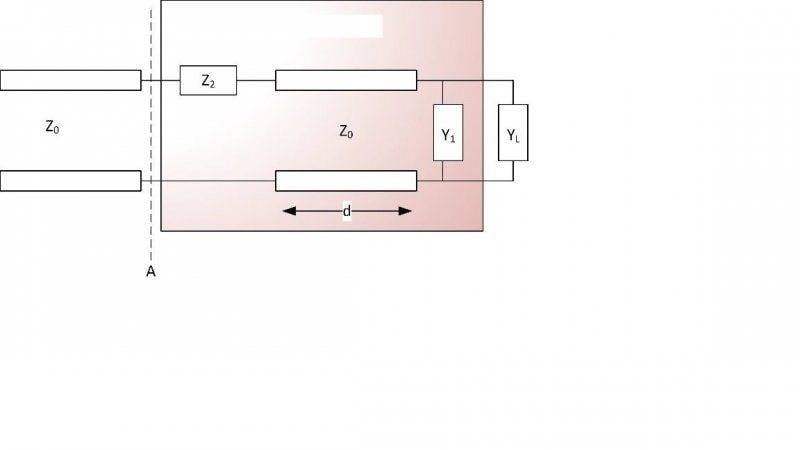

Please see attached diagram. The question reads as follows:
In order to match (impedance wise) a transmission line without any losses to a load with impedance ZL the matching network is used, as shown in the diagram attached. Both Z2 and Y1 in the diagram are pure imaginary and connected in parallel and in series (as shown) to a transmission line of length d. It is stated that the matching network cannot match a load with admittance whose real part is greater than 1.6. I am then asked to use a Smith chart to determine the possible values of d. I did that, hopefully successfully, and obtained d=0.133λ, 0.383λ. The question then states the possible values of d to be d1=0.4λ and d2=0.1λ. The normalized Y1 and Z2 of the network are also given, as Y1=1.2j and Z2=1.2j. At this point I am asked to find all the possible values of the normalized admittance YL for which a perfect matching is obtained at point A in the diagram.
I am not really sure how to determine that using the Smith chart. I have tried writing the following equation, but I am not sure it'd get me somewhere:
YinA=1=Y2+YinT+Y1+YL, all normalized of course and where YinT refers to the transmission line.
I'd appreciate some guidance.
