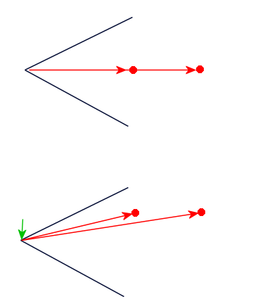

For a visual representation, the black lines are your field of vision. Your motion is "downward" in the figure.
Two diagrams of a viewer's field of view as two wedge-shaped black lines, with two red dots on sight lines: top shows both dots on one horizontal line; bottom shows a green arrow of motion and the sight lines to the near dot shifted more than to the far dot.
At first, both the distant and near object are in the center of your field of vision and along the same sight line.
At some moment later, you have moved to a new position relative to the objects as shown by the green arrow. The new sight lines to the objects are shown. Even though your relative motion and resultant shift in position relative to both objects is the same, the sight line to the nearer object has shifted more than the sight line to the further object. Extrapolating this forward and backward in time has the nearer object entering your field of vision well after, leaving it well before, and taking less time to cross your field of vision than the further object does.
  • Two diagrams of a viewer's field of view as two wedge-shaped black lines, with two red dots on sight lines: top shows both dots on one horizontal line; bottom shows a green arrow of motion and the sight lines to the near dot shifted more than to the far dot.
This is more convincing and simple explanation
Thank you [emoji3531]
Janus's diagram also (nearly) shows why very distant objects such as the Sun or Moon do not appear to move at all. They are almost at infinity, so the line of sight remains in the same position. I remember asking my father this very question when I was small and staring out the car window. Trees flashed past but the Sun was steady. His correct explanation went over my head.:cry:
