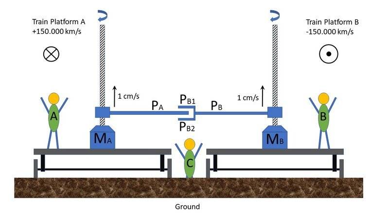

In the situation below there are three observers:
  • A: Standing at a moving train platform moving at a speed of c/2 relative to “the ground”.
  • B: Standing at a moving train platform moving at a speed of c/2 relative to “the ground”, but in the opposite direction as A.
  • C: Does not move against the ground.
On train platform A and B there are long plates (PA, PB) that both move upwards with a speed of 1cm/s.
So, what does every observer see:
  • C: A and B move at the same speed (in opposite directions) relative to C, so plate PA stays between PB1 and PB2. => nothing breaks
  • A: sees that B moves at high speed. According the relativity theory everything on platform B is going slower. So, the upward speed of plate PB (1 cm/s) will also be lower. Therefore, plate PA will bump against plate PB1. => plate PB1 breaks
  • B: sees that A moves at high speed. According the relativity theory everything on platform A is going slower. So, the upward speed of plate PA (1 cm/s) will also be lower. Therefore, plate PB2 will bump against plate PA. => plate PB2 breaks
So, the three observers arrive in a completely different reality. (C: nothing breaks, A: PB1 breaks, B: PB2 breaks)
Can someone please explain what really happens and how that is in accordance with relativity theory.
Thank you!

You're showing end-view, so the dimensions of the 'plate' along the direction of motion is unspecified, but I presume this means that they're not just rods passing at a single moment without collision.
The plates moving upward require each end to be raised in sync, which requires a clock synced to one frame (presumably the frame of the moving platform) and not the others. Since the clocks will not read the same time as they pass each other, the plates will collide and things will 'break' as you put it.
Where are the observers? At the front of the plates, middle, or end? They'll only be in each other's presence momentarily, so they're not expected to observe the same local thing. Assuming they're at the front and things look like the picture at the beginning, both observers A and B will each see the front of his own horizontal plate get hit by the contracted and angled far plate which locally rises faster due to its non-horizontal orientation. So none of your answers describe that.
Observer C sees the same collisions occur, but not right in front of him.
There is no way to even set up this scenario, because of relativity of simultaneity. If all parts of PA are at the same height at the same time relative to A, they won't be relative to B; and if all parts of PB are at the same height at the same time relative to B, they won't be relative to A. So the plates can't even be set up as you describe.

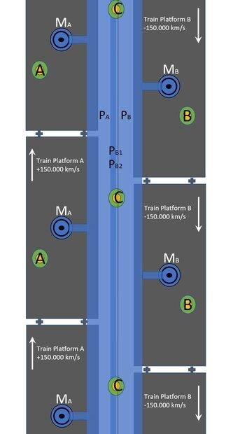

To make the experiment clearer I offer some extra information.
The picture below gives a view from above.
  • The train and plates are very long (infinite).
  • On each platform we set an observer (A, B), and also on regular places on the ground (C).
  • In the begin situation:
    • the trains do not move.
    • the plates move already at constant speed (1cm/s)
    • PA is in between PB1 and PB2.
  • The trains accelerate symmetrically till they reach their final speed: +/-150.000km/s
  • The engines (MA, MB) that lift the plates can be considered as clocks. (position => time)
Note that all observers of type
  • A: see plate PA will bump against plate PB1. => plate PB1 breaks.
  • B: see plate PB2 will bump against plate PA. => plate PB2 breaks.
  • C: see plate PA stays between PB1 and PB2. => nothing breaks

No, because you have still failed to account for the relativity of simultaneity, and have just made the problem more complex by introducing acceleration. A problem you could do with pen and paper is one where the carts are always moving at constant speed. You just need to specify the frame in which the plates are horizontal (probably C's (edit: has to be C's if the lifting devices are identical, in fact)) and work from there. You also need to use the full Lorentz transforms rather than just time dilation, which is a special case of the Lorentz transforms that isn't sufficient for this problem where you have synchronisation issues.
There is no paradox in the accelerating case either, by the way, but it's vastly more complex and offers no additional insight.

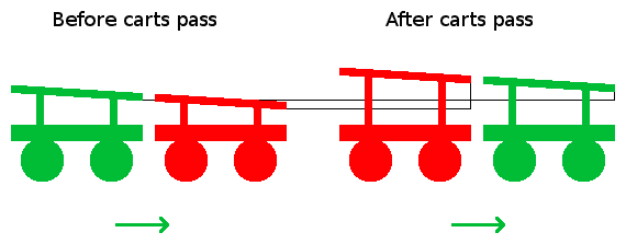

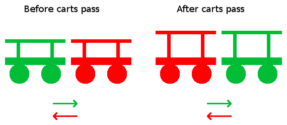

Here's a side elevation of the situation, as drawn using C's rest frame. The carts move with equal and opposite velocities, green to the right and red to the left in keeping with maritime customs. The plates are horizontal and have risen by the same amount during the cross over.
Now let's sketch it in the rest frame of the red cart. The green cart is still moving to the right, but faster, and the red cart is, of course, stationary. The plates are slanted. I've added fine black horizontal and vertical lines linking the green and red carts before and after so you can see that the red cart's platform has risen further than the green cart's during the cross over. The platforms remain aligned due to the slant and the motion of the green cart, so there is no collision.
These diagrams are not to scale, but the concepts are there.
