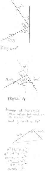

Calculate the change in momentum of a 120g pool ball hitting at 9m/s and rebounding at 6m/s. It rebounds at an equal and opposite angle of 45 degrees.
Pi = 9m/s
Pf = 6m/s
angle = 45 degrees
I have done all my calcs in the picture below which shows a diagram
I have concluded that the impluse was 10.8166 N, somehow I don't think I have done this right
Well, you're right that you're wrong. Given that the impulse I = m\Delta v, consider breaking the velocities into orthagonal components. Which component will the normal force change? :wink:
looks fine :smile:, except that you've not yet multiplied by the mass :wink:
(and do you need to specify the direction of the https://www.physicsforums.com/library.php?do=view_item&itemid=340" also?)

Also, I have trouble remembering which one to flip around and make a negative? Is there are certain rule of guideline I have to follow to do this?
i'm not sure i follow :confused:
if the momentum before is p = (a,b), and the momentum after is q = (c,d),
then the change in momentum is q - p = (c-a,d-b) :wink:
What I did, was I flipped the 6m/s around so it becomes -6m/s (beause I took them way like vectors). Because it is on an angle of 45 degrees, I added the vectors head to tail
is this right?
hi miniradman! :wink:
yes, you can either subtract the original vectors, tail-to-tail, or flip one so that it becomes adding, which is head-to-tail :smile:
awesome! Thanks mate ;)
