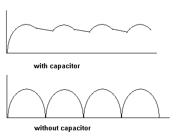

yes, the second 1/2 cycle. BUT the capacitor never fully discharges between cycles. In fact, it is why the capacitor is used after the
bridge rectifier ... to keep the avg voltage up.
AC voltage BEFORE the rectifier ...
Rectified voltage AFTER the rectifier ... NO Capacitor ...
Rectified voltage with smoothing capacitor added ( top diagram)
Note that the voltage no longer drops to zero as in the lower diagram

From the graph when the capacitor is discharging, why is the voltage drop across the load is the equal to change in voltage across the capacitor? Since there is still current coming out from AC generator, hence, shouldn't the voltage drop across the load equal to the sum of voltage drop across the capacitor and the AC generator at that very instant?
The voltage across the load is not equal to the _change_ in capacitor voltage. It is equal to the capacitor voltage because they are in parallel.

as the voltage from the generator starts building up for the second 1/2 cycle then the voltage on the capacitor starts
increasing again. The capacitor only starts discharging for the briefest of time
