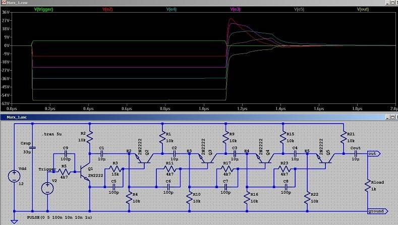

Attached is a schematic for a repetative pulse generator in the style of Marx.
A small positive trigger produces a short high voltage negative pulse.
It is modeled here with a few low voltage stages, but could be built with say 16 stages of 650V transistors and components.
  • LTspice screenshot of a multi-stage Marx-style pulse generator schematic with five 2N2222 transistor stages, and above it a transient plot with traces labelled V(trigger), V(e2), V(e4), V(e3), V(e5) and V(out) over 0 to 2 microseconds.
