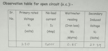

Hello Hardy Sir,
I have attached a picture containing the parameters calculated by measurement and theoretically. In the picture, I could not do the theoretical calculations of leakage reactances. The practical measurements are done by performing open circuit and short circuit test. The parameters are referred to primary.
Can you please look at the parameters and say if they are correct? I have doubt in Rc and Xc.
I see two columns of figures there with no mention from where they came. How would i judge if they are correct? What did you measure ? How did you calculate them from your measurements ?
You'd have to show your work.

Here's an equivalent circuit for a transformer, from Wikipedia.
At no load the only things dissipating power are Rp and Rc .
Did you measure the resistance of your winding Rp with an ohm meter ? What is it ?Your datasheet (this sure looks like homework ? A lab report due soon?)
tells you to ignore Rp for the open circuit test and ascribe all power to iron loss, Rc. See parentheses under "Wattmeter".
For the moment let us also ignore Xp , since it has only 5 ma through it the voltage drop can't be much.
Your observation tells you that no load power is 0.85 watt.
You know that P = E2/R, so R = E2/P
(230 volts)2 / 0.85 watt is how much resistance ? That's Rc.
230 volts / 0.005 amps is how much impedance ? That's the parallel impedance of Rc and Xm, ignoring Xp..
What inductive reactance in parallel with Rc gives you the parallel impedance you just calculated ? That's Xm.
Now from short circuit test
teacher has again ascribed all power to one place, the copper.
That's not a bad assumption because flux in a short circuited transformer is quite low and losses are proportional to flux^(some power slightly greater than 1)
Which means in the model above I am and Ic both drop to zero, or near enough zero to ignore.
So
12 watts = Ip2 X Rp + Is2 X Rs
and you can measure both Rp and Rc with an ohm meter.
By ohm's law we know what is voltage across Rp and Rs .
The rest of the applied voltage has to be dropped across the leakage reactances Xp and Xs . But you knew that already.
By ohm's law we also know what is impedance of the transformer when short circuited, 24.5 volts / 0.49 amps.
Call that Zsc for now.
What inductive reactance in series with sum of resistances Rp and Rs will give you Zsc ?
That's the sum of Xp and Xs in the above model.

I'm sorry but i just can't follow your calculations from those images.
There's an approach. Try it to cross check your calculations.

Hello Hardy Sir,
Actually, the company in which I am doing my Master Thesis uses a software which on entering some basic input values and assuming some parameters gives the output of the transformer with electrical circuit of transformer and all other parameters.
I am trying to find some relation with the values provided by software with actual measurement of the transformer and also by doing calculations mathematically.
This photo is not some homework. I just downloaded it from net and put in the values measured to make you understand better.
The values from the measurement are determined by formula from the following link:

So his and my methods are nearly identical except
he calculates Rp and Rs by using the wattmeter and ammeter to determine Power Factor (PF) instead of using an ohm-meter tp measure them directly. Sounds roundabout to me.
I personally don't trust a wattmeter to have much precision. Especially with only 5 milliamps of current through it.
So i suggest you check your wattmeter/PF derived numbers for Rp and Rs against a decent ohm meter.
Be aware that inductance of a transformer likely will confuse a DMM , so measure each winding's resistance with the other winding shorted else your DMM may just flash meaningless random numbers.
If you study his and my method you'll find they are the same. Just he solves for R using a wattmeter&ammeter derived power factor and phase angle where i used ammeter&ohm meter , Pythagoras, and rectangular - polar impedance conversion .
I trust Mr Ammeter and Mr Ohm-Meter more than i do Mr Wattmeter. But that's a personal preference. You should determine resistance of windings both ways and see for yourself how closely they agree .
That author had trouble reading a wattmeter at such low power factor and small current. He even got a special watttmeter .
When the transformer is operating on no load, the current drawn by the shunt or parallel parameters is very small about 2 to 5 percent of the rated current. Thus, a low current will flow through the circuit during OC test. In order to be readable by the instruments, the measurements of voltage, current and power must be performed in the low voltage side.
And also, low range current coils and low range ammeter must be selected. The power factor of the transformer on no load is too low which is typically below 0.5 . So in order work with this low value, a LPF watt meter is selected. The equivalent circuit obtained by the OC test is shown below.
He ignored both Rp and Xp in his OC test which is a practical simplification that you can get away with because it doesn't cause much error.
note how closely it resembles this from the Wikipedia model
R and X represent core's iron loss and magnetizing current requirement.
Study that Wikipedia transformer equivalent circuit. Had your author used it in his paper it would have been a lot more easily understood.
I don't know what is your thesis topic
but i'd think you would want to understand the transformer model . It's a very nice tool to have in your "Bag of Tricks" .

Hello Hardy Sir,
Thank you very much for the compliment.
Now, With ohm meter I measure Rp=23.5ohm And Rs1=Rs2=O.7 ohm(two secondaries), The turns ratio =Vp/Vs= 230/24=9.5833.
With referred to primary and parallel equivalent resistance I get Rs'=32.12ohm. So the addition is Rp+Rs'= 55.62ohm.
from Short circuit test Zsc=Vsc/Isc= 24.5/0.49= 50ohm,
Rsc= P/i^2sc= 49.97ohm, so when referrd to primary I get Rp=Rs'=Rsc/2= 24.98ohm,
Xsc=1.73ohm, therefore Xp=Xs'=Xsc/2=0.86ohm
This is the problem I am facing when I actually measure the resistance with ohm meter as without short circuit test I cannot calculate Zsc and therefore Xp and Xs'.
