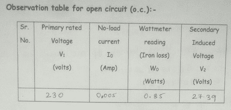

[QUOTE="Jimmy Lalani, post: 5825807, member: 628145"T]he turns ratio =Vp/Vs= 230/24=9.5833.[/QUOTE]
Published numbers are for operation at rated load. They include voltage drop across Rp Xp Rs and Xs.
Turns ratio looks to me more like 230 / 27.39 = 8.397
That's why you run open circuit test, to eliminate or at least minimize the voltage drop across Rp Xp Rs and Xs
@Jimmy Lalani Try your calculations using observed turns ratio at open circuit
because that is when voltage drops across those impedances are negligible.. You'll come a lot closer to the actual turns ratio.

1) Is it possible to calculate the no load voltage mathematically? According to my observations it is always between 10-20% more than the rated voltage. However I am interested in calculating it mathematically.

?? i thought you measured no load current as 5 milliamps. See your 'observation ' table.
Which instrument do you prefer to believe , the wattmeter or the ammeter ? If the ammeter is digital and reading only on its least significant digit it's not very accurate.

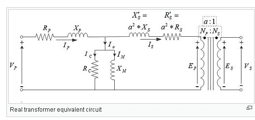

Have you studied the wikipedia article on transformer model? It's at
https://en.wikipedia.org/wiki/Transformer .

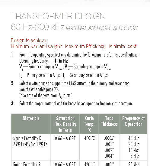

Thank you for the pdf file you provided me. I have 600VA, Vp=230V, Vs=36V, f=400Hz Toroid transformer. B=1T(I assumed this value as at 400 Hz B is between 1-1.2) Is it correct? Or should I also calculate Bm?
1) From this I found data such as Ip=2.608A, wire diameter=1.12mm, Area=0.9858mm^2 b) Is=16.67A, wire diameter=2.85mm, Area= 6.1575mm^2
2) From the pdf file you provided I calculated WaAc Product and compared it with my table for cores and I found the core 70x42x40mm. Is it correct?
I have a doubt how do we decide IDmin, ODmax, Hmax? Can I directly calculate WaAc product from the normal core provided and then compare it with the value from above formula?
3) Number of turns N= V/(4.44BfA)
4) length of one turn = 2h+(OD-ID)
Your core datasheet will tell you if it can operate at 1T. Sounds reasonable for decent transformer steel.

Jimmy Lalani said:
No load current= Pi/Vp= 6.765 mA ?( is this correct way to calculate as I have not included power factor)
No load current is the sum of IC and IM . What we just calculated is IC
Jimmy Lalani said:
How do I calculate Xm?
To find IM you will have to go back to your wattmeter and current readings.
Excitation current that you measured with ammeter in open circuit test, I0 , is IC - j Im .
However - i am skeptical about resolution of a wattmeter at such low power. It might be advantageous to measure current and its phase angle with an oscilloscope. Then you'll have current and power factor at no load from the same instrument.

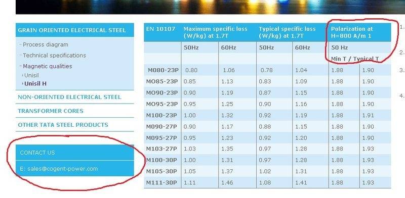

I ahve attached a file below regarding the watt/kg value which I have taken of the material specified. It shoes only for 50 and 60 Hz. looking at this values I ahve taken 1.1 for 100 Hz. unfortunately there was no µ and Al value.

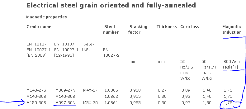

Well here's their list of datasheets
https://cogent-power.com/downloads
though i don't see M097-30N
here's a snip from one at https://cogent-power.com/cms-data/downloads/Hi-Lite_NO30.pdf
it seems to have B vs H tabulated
sometimes those part numbers are cryptic
if you can't find your core material on their site
i guess you'll have to take them up on this offer
and ask for help finding the right datasheet.
Does that "Polarization" in right hand column work out to μrelative about 1900 ?

It's correct for 1T
but they show 1.88 to 1.9 Tand that looks reasonable , here's a similar datasheet from another manufacturer .
http://www.aksteel.com/pdf/markets_products/electrical/AK%20CARLITE%20Lite%20042413.pdf
10 Oersteds is approximately 800 A/M(795.7) and 18 kilogauss is 1.8 Teslas

Fantastic find there @Tom.G
Never dawned on me there was a method to those cryptic numbers .
I learn something every day here .
From your first link
I think that was @Jimmy Lalani 's missing piece.
