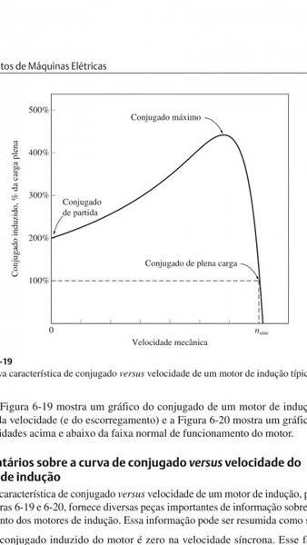

As a EE student, I studied Induction motors: three and single phase. I saw somewhere that Tesla's autos are using induction motors feeded by batteries. But I've never heard about DC induction motors.. I also heard that Tesla autos have torque constant for every speed, but that's also not how induction motors behave. Any Ideas? Thanks!

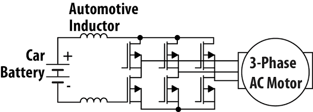

I would assume these vehicles use electronics to convert the battery's DC to an AC that can drive the AC motors. Possibly this inverter might produce 3 phase AC, with 3 phase motors being both light and powerful.
There is an inverter connected to the battery which converts dc into three phase ac.

Thats enlighting for the power supply question. How about the constant torque?
This rate of DC-AC conversions are mostly controlled with DSPs in every detail. Phase, frequency, current (even waveform can be changed , if one has some wicked ideas) as function of thrust and speed - you can do as you please as long as the hardware can endure it.
Likes Phellippe Marques
Likes Phellippe Marques and cnh1995
Guys, I understood both the Dc-Ac conversion process in order to feed the 3phases induction motor, and the idea of controling the parameters to keep the output torque constant. I thank you all for the attention and help. Its enough for me, for me, the topic may now be closed
