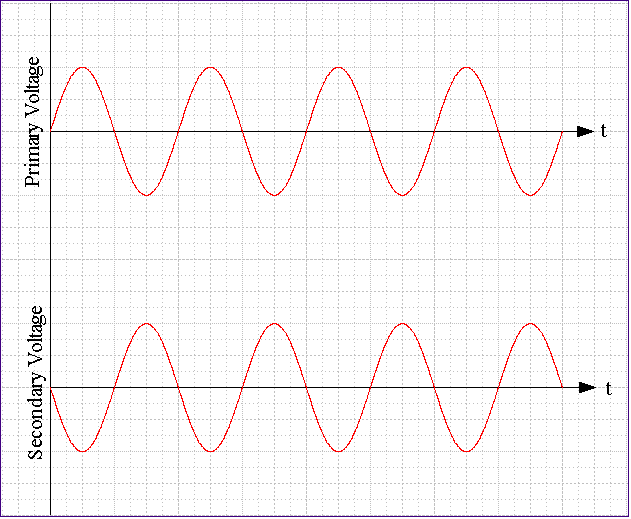

But at the bottom of the coil the voltage goes down and then up (relative to the top or some zero in the middle).
This is what they call "reversed phase".
(Note that with reverse winding, this would also reverse the phase.)
Btw, since this information about winding direction and points is given in the comments section, that makes me reconsider the meaning of the dots.
Now I think the dots symbolize that the phase is reversed.
I have to admit that I was not aware of such a convention.
That means that when Vp goes up, Vs goes down.
And when Vp goes down, Vs goes up.
Errr... yes, it is wrong assuming U(rms) and U(max) are voltages.
Aha! So in that case, this is wrong
http://img855.imageshack.us/img855/3387/vpvs.jpg
Should be
http://img171.imageshack.us/img171/136/reallyshould.jpg

In this case we can conclude that the construction is such that the phase reverses.
This would for instance happen if the coils are inside each other with a reverse winding.
Should be
Yes, but this is only when the current in the primary circuit is flowing as you indicated.
It will still also flow the other way.

@Fp: Can you now draw the graph for Vs?
It should have a lower amplitude than Vp, and it should have a reversed phase.

Since Vs is reversed in phase with respect to Vp, Vs would be negative when Vp is positive and Vs would be positive when Vp is negative.

So the max voltage is indeed 230 \sqrt 2.
It would be nice if you marked that in the graph for Vin, Vp and Vs.
And now we know that the voltage is indeed transformed down by a factor of 2.

  • #45
Hi FP, you may wish to think about the relative phase of the primary and secondary waveforms; how do the transformer 'dots' affect the phase?
While this phase difference won't make any practical difference in the operation of this simple circuit, it's worthwhile making note of it since you're drawing Voltage vs Time graphs.
  • #46
Well it reverses the phase on Vs. But I don't know how to show the difference in a graph though since Vp is both directions anyway, and Vs is one direction.
I hope I understood what you meant.
  • #47
The difference shows up as a reversal of polarity in the secondary voltage waveform with respect to the primary's waveform. This is equivalent to a half wavelength shift in time for the secondary voltage waveform. It boils down to shifting your graph's peaks over by a half wavelength (either direction will do!).
Note that this is only necessary if you are showing voltages in both the primary and secondary circuits on the same time axes.
All your analysis conclusions still apply, only the time-wise locations of the peaks are shifted over.
  • #48
Ah, makes perfect sense :smile: I get it now.
I'll fix it then in my next scan this evening or tomorrow. Thanks :approve:
