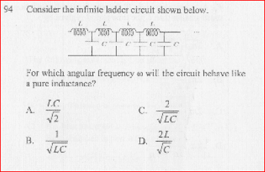

Multiple-choice problem: infinite ladder circuit of series inductors L and shunt capacitors C, asking for the angular frequency at which it behaves like a pure inductance. Options: LC/√2, 1/√(LC), 2/√(LC), 2L/√C.
Capacitive Reactance Xc = 1/ωC ; Inductive Reactance XL = ωL ; Some Phasor Algebra etc.,
Well, Basically like we solve the circuit for resistances with DC Supply, I tried to assume the total impedance of the Circuit as Z. Then leaving one block, replace all by an Inductor with impedance Z.
This is where I'm getting stuck!

I don't really understand what you did in this last part. I would focus on figuring out just what Z is first. To do that, realize that the impedance is still going to be Z if you add another inductor + capacitor pair to the left side of the circuit. So you can set up an equation:
Z = Impedance of: (inductor) in series with (parallel combination of capacitor and Z)​
Use the actual impedance expressions for the inductor and capacitor, and solve the equation for Z. The algebra gets a little tedious, but after you get an expression for Z, you can then look at the expression and figure out how to make it consistent with a pure inductance.

An LC circuit without resistors is singular at its resonant frequencies: the impedance can be zero or infinite. Try to build the ladder step by step with ω=1/√(LC). What do you get? Can you apply the "ladder method" ?
If you apply the "ladder method" what do you get for Z? Does the angular frequency C give a meaningful solution?

I will give one suggestion though. Let s = jω then the impedances of the inductor and capacitors are given by sL and 1/(sC). Use Redbelly's suggestion and find Z such that
[tex]Z = sL + \frac{Z\,\frac{1}{s C}}{Z + \frac{1}{s C}}[/tex]
The algebra won't be too bad, and you'll end up with a quadratic in Z. From the roots of the equation (quadratic formula) you should be able to spot what s (and hence ω) needs to be in order to leave just an "sL" type term.

Yes, Got it thanks. The answer turned out to be (C)
