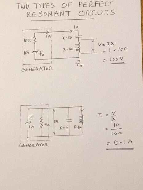

You must specify the resistance of the driver, which is connected to the resonant circuit and so defines the Q or magnification factor, preventing it being infinite.
Further to my #16, I have attached a diagram of two perfect LC resonant circuits. I am sorry to use electrical rather than mechanical examples. In both circuits the currents and voltages are dictated by the resistance in the generator and you will see that they are not infinite.
