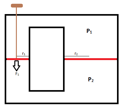

I probably haven’t thought this through. A sideview of a closed container filled with air consisting of two vertical cylinders (with radius ##r_1## and ##r_2##) are connected by two horizontal tubes. The container is separated by a small and a large lid (red) that are circular and can move up and down freely. Furthermore, the small lid is connected to a handle that sticks out of the container to move it up and down. There is a pressure equilibrium; ##P_1 = P_2##
Pushing the handle down with a force ##F_1## makes the small lid move down by a distance of ##d_1##. The work done on the small lid would be ##E_1 = F_1 \cdot d_1##.
This would make the pressure ##P_2## increase and the large lid would undergo a force ##F_2## which makes it move upwards by a certain distance ##d_2##. According to the conservation of energy ##F_1 \cdot d_1 = F_2 \cdot d_2##.
Here’s the thing however. When pushing the small lid down, a vacuum arises in the upper container half which would counter the force ##F_1## and make the moved distance ##d_1## smaller than expected. At the same time, that same arised vacuum would support the force ##F_2## and thus make the moved distance ##d_2## of the large lid larger than expected. The work done on the smaller lid would therefore seem smaller than the work done on the large lid. Wouldn’t this vacuum thus break the conservation of energy ##F_1 \cdot d_1 = F_2 \cdot d_2##?

Are you considering a quasi-static situation where the pressure is uniform throughout each section or are you considering dynamic pressure waves in the container? Are the lids considered massive or massless?
Quasi-static and the lids are considered massive.
First, there is an external force acting on the system. Why would energy be conserved? Second, you push the plunger and both lids start moving. Why would the net energy be the difference of the motions and not the sum? (Plus the motion of the air if you wanted to be complete) Finally, instead of one pressure and vacuum, think in terms of a pressure difference between the top half and the bottom half. Both “lids” experience the same pressure difference at all times in the quasi static model.

For ideal conditions, with no energy lost, pushing the handle down distance ##d## with force ##F_1## will produce the work of moving both pistons and both masses of air inside the container.
The chain of events inside the container do not change the magnitude of input work.
##W## = ##F_1## x ##d##
Likes Cutter Ketch
If you give the plunger a quick push, in the quasi static assumption, and with no friction a pressure differential will only exist while you are pushing. When you stop pushing, both pistons will be moving as will the air. The total kinetic energy imparted by the push is the sum of all of those. The small one will be moving faster than the large one according to their diameter. They and the air will continue to move under their own inertia (the air has inertia too) until friction (ok, you said no friction) and loss in the air stops the movement or the pistons run into the corners. We could say no loss in the air, but given that the air has to squeeze down and speed up as it enters the small side, and vice versa, it is hard to imagine that the airflow won’t significantly resist the motion (in which case there will be a backwards pressure differential slowing the pistons down)

I see where you were going with that. The work done by the force equals the work done on the two pistons is a good idea. I think significant work is also done on the air, but let’s ignore that for a second.
Let’s see: the net force on piston one is not just the pressure differential times the area. It is the applied force minus the pressure differential so you’d have to fix that. The pressure differential is the only force on the second piston, so that seems right. I’m afraid the biggest problem is that the pressure is not constant during the push. At first the pressure differential is zero, and the force accelerates piston one. This increases the pressure differential reducing the net force and acceleration of piston one while accelerating piston two. Eventually you arrive at a condition where the pressure differential equals the applied force and the pistons move at a constant speed.
If you had written your work equation with integrals over the path (given that you would still be ignoring the work done on the air and correcting the other things I) then I think you could write a work relation like that. Unfortunately it wouldn’t be terribly useful, because you don’t have any prior knowledge of the pressures as a function of time or distance moved.

No. The force applied to piston 1 makes piston 1 move. The movement of piston 1 eventually makes ##P_2## higher than ##P_1##.
If the piston is massless or if the motion is slow enough that the acceleration rate is negligible then Newton's second law has something to say:
$$F_1+(P_2-P_1)\pi r_1^2 = ma = 0$$
Since the force of that pressure gradient can also be applied on piston 2, the work of the pressure gradiënt is spread over both pistons and thus the force on piston 1 does not have to be equal to ##F_1##.
Rather than "force of that pressure gradient", I would refer to the net force on piston 1 and the net force on piston 2 arising from the pressure gradient. Yes, both forces arise from the pressure gradient.
[The term gradient actually has a slightly different meaning, but I will use it here in the same way that you have -- to mean "pressure difference"]
I do not know what "the work of the pressure gradient" is supposed to mean. One can compute a figure for work and associate it with a pressure gradient by multiplying the pressure gradient by a volume swept out. Yes, there is a work that can be computed based on the volume swept out by piston 1 and a work that can be computed based on the volume swept out by piston 2.
None of that negates Newton's second law. For negligible mass or negligible acceleration, the applied force at piston 1 is still equal to the pressure difference multiplied by the area of piston 1.
I think it's better to describe my scenario in more detail; I am considering the pistons to move by the pressure gradient only after force ##F_`1## has been applied and piston 1 has finished moving ##d_1 \downarrow## by it. So during ##F_1## and the downward movement of piston 1, piston 2 is held in place.
So you latch piston 2 in place to begin.
You force piston 1 slowly downward, applying just enough force to match the slowly increasing pressure gradient. During this process, some work is obviously done by the applied force.
Now you latch piston 1 in place. A pressure gradient now exists. Everything is at rest. Energy has been conserved. There is pressure energy in the working fluid.
You now release the latches that hold both pistons in place and let them snap back into a new equilibrium position? Or do you release them and apply a force on both pistons so that they each gently relax back into a new equilibrium position? Or do you release only piston 2 and let it snap or relax to a new equilibrium position?
Based on the original problem statement, I think that you mean to release only piston 2. You want to do it slowly, resisting the resulting motion with an external force ##F_2##. This external force will draw off the energy that had been originally injected by external force ##F_1##.
Where does a supposed discrepancy come in?

In the idealized case (massless pistons, massless fluid, no friction), you do not have a well defined result. Non-zero restoring force and zero mass means infinite acceleration. Two zero masses means that the mass ratio is not well defined. We cannot tell which piston will move more than the other.
If we give the pistons some mass but leave friction out of it, we will end up with simple harmonic motion. The pistons will both oscillate about some new equilibrium point. For a massless fluid, the speed of sound is infinite and the oscillations will continue forever and stay in phase with each other. The relative amplitudes of the vibrations will depend on both the mass ratio and the area ratio of the pistons. The frequency of the vibrations will depend on the masses, the areas and the volumes of the two reservoirs.
It is for this reason that I wanted to simplify the problem by slowly releasing piston 2 only against a resisting force ##F_2##. We can, if you prefer, simplify by releasing both 1 and 2 against new resisting forces ##F_{\text{1b}}## and ##F_{\text{2b}}##
In either case, we will find that the work done by original force ##F_1## is equal and opposite to the sum of the works done by the forces during relaxation.

In that case would you still say that they'd have different initial accelerations?
Yes. Certainly so. Depending on piston mass, piston area and pressure difference. In the absence of friction, one could come up with a formula for the resulting simple harmonic motion.
In the presence of [linear] friction, the differential equation is somewhat more difficult but typically resolves to the product of a decaying exponential and a sine wave. In this case kinetic/pressure energy is drained into thermal energy, of course.
Likes Lnewqban
Could you please tell me what I'm donig wrong here?
In the case of a pressure difference while holding the pistons and then releasing them to relax (without applying any additional forces) the pressure force on piston ##1## would be ##F_1 = (P_2 - P_1) \cdot \pi r^2_1 = m_1 \cdot a_1##. The pressure force on piston ##2## would be ##F_2 = (P_2 - P_1) \cdot \pi r^2_2 = m_2 \cdot a_2##.
I can see from this that ##F_2 = F_1 \cdot \frac{r^2_2}{r^2_1}## and that ##m_2 = m_1 \cdot \frac{r^2_2}{r^2_1}##. Substituting ##F_2## and ##m_2## with these for the force on piston ##2##:
$$F_1 \cdot \frac{r^2_2}{r^2_1} = m_1 \cdot \frac{r^2_2}{r^2_1} \cdot a_2$$
$$= F_1 = m_1 \cdot a_2$$
Therefore, I see that ##a_1 = a_2##.
As I understand this, you are assuming that the pistons are both of the same thickness and that the material is of the same density. So the piston masses are each directly proportional to area and each with the same constant of proportionality.
Yes, under this assumption, the accelerations of the two pistons are identical to each other.
So far so good. Why do you suspect this to be wrong?
Likes Lnewqban
Because you said in post #26 that the initial accelerations would be different in this scenario. Perhaps I have missed your point but I'm not sure how.
That was in the scenario where we were resisting the relaxation, not the scenario where the relaxation is free.
Oops. On review, that I was not sure we were dealing with same density, same thickness at that point.
  • #31
Ah ok. You said furthermore that it will show an oscillation when there's no friction.
In the presence of friction, would this mean that the pistons would stop at positions where the pressure difference is zero?
  • #32
Yes. At least in the case of a friction that is proportional to velocity (e.g. viscosity in the fluid).
If we are talking about a fixed retarding frictional force (e.g. piston rings against cylinder walls) then the stop positions might have a small non-zero pressure difference compensated for by the small non-zero static friction.
Likes Lnewqban
  • #33
jbriggs444 said:
Yes.
Assuming both pistons would swipe the same volume to reach equlibrium, does this mean that piston 2 would move a distance that is a factor ##\frac{r^2_2}{r^2_1}## smaller than piston 1, even though they have the same initial acceleration? (again, no resisting forces added).
  • #34
I thought that we had decided that pistons with equal thickness and equal density would experience equal accelerations at all times subsequent to release. Would they not then sweep out equal distances and not equal volumes?
I will assume here that any friction is from fluid viscosity and not from the pistons on walls.
Likes Lnewqban
  • #35
Ah, my bad. I was taking piston 2 's larger inertia to decelerate into account but I forgot that its larger area of force at pressure equilibrium would also compensate for that.
One last question; if friction from the pistons on the walls are taken into account, would the distances swept out by the pistons differ? If so, does this mean that pressure equilibrium is not reached?
