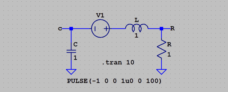

The RLC circuit has two initial conditions (states) for the transient response, which are best represented (IMO) as capacitor voltage and inductor current. He doesn't have to "think" the inductor current is zero, he's telling us the initial inductor current is zero. You/he could choose whatever value you like.
I suspect much of his confusion is applying these ICs to the general transient solution. But, then he said the Q(t) solution was "given", so I guess that's one IC. I haven't actually reviewed the math, sometimes it's easier to give the answer than troubleshoot.

Voltage source is initially 1 V, then goes to 0 V at t=0.
DaveE said:
That is an initial condition that can't be calculated, it must be defined in advance for transient response problems.
